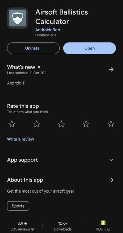

I've got two phone apps I use for this, to make it easy if it's for a weight or power I haven't memorised.
First is the Airsoft ballistics calculator, that one just lets you find the power of a specified weight BB at whatever velocity you get.

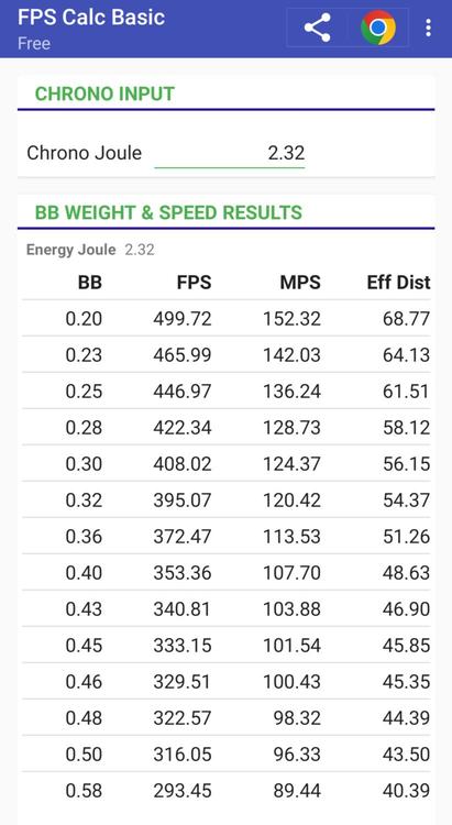

Second is/was called FPS calc basic.
This one works in reverse, where you put in the required joule limit and it'll show you what the FPS limits will be for a large variety of BB weights.
I don't know if this one is still available to download as a quick look on the app store didn't immediately bring it up.
