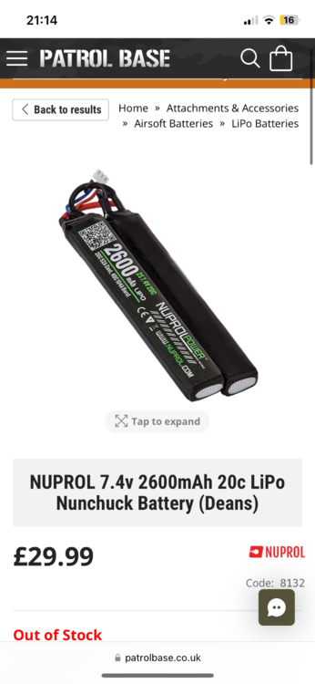

Hi all I upgraded the motor in my sa-eo3 and since it has started misfiring. It only happens in semi auto and the motor randomly begins spinning and then stops midway through before the piston moves fully. The motor works perfectly before it interacts with the gears ,the battery is brand new and fully charged. Does anyone have any ideas what could be causing it?

You say its 15c but pic shows 20c
I guess its not enough power for a hi-speed motor so you might need a 25c battery.
With the MOSFET I don't think you can use 11.1v
