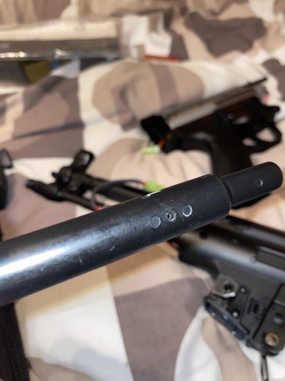

Recently picked up a lovely CYMA CM041 w/ a torch handguard, but unfortunately due to roller delayed related mind control I ended up fucking the charging handle that's within the cocking tube, I know: no way - I was going to order a replacement but thought I'd have a look beforehand so I could see if the guarder steel replacement would fit but I can't even get the thing out - any pointers?
image.thumb.jpeg.4de8cf23d0a548b7bf0572e44e8efcb4.jpegimage.thumb.jpeg.18f46b5ebc19b84feb40eb0b022a678d.jpeg

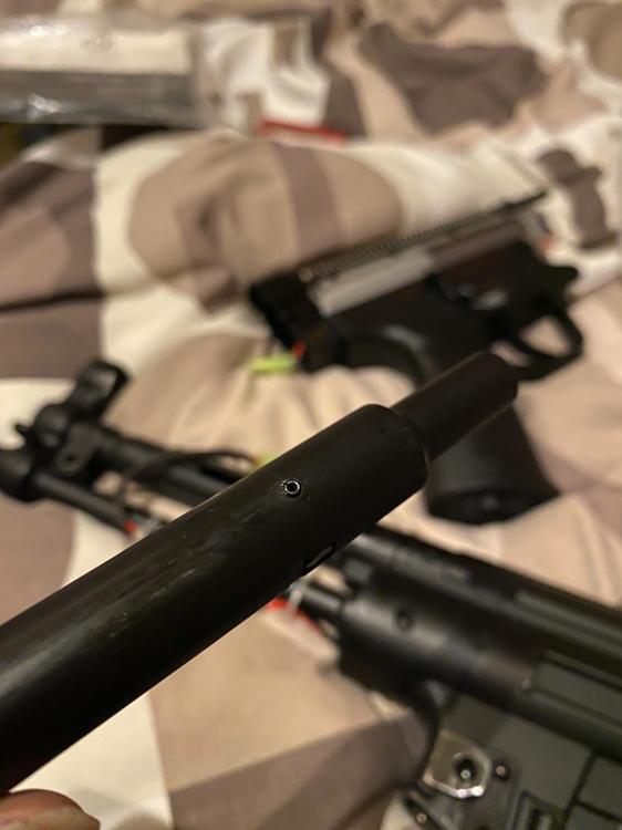

The grub screw/allen screw that's inside just either free-spins or doesn't fit a single one of my allens, and I've tried several different sizes. Am I doing something wrong or do I just need a hyper-specific key to fit it?
Hard to say for sure, but it doesn't look like an allen key bolt, more like a roller pin. Probably needs a punch (or screwdriver) and a hammer to tap it out.

Gotcha, I mostly just lurk and post in other people's threads so I wasn't too sure where it should go. I'm pretty sure the mods have moved one of mine in the past though.
Also I'll give it a little go with a pin-punch tomorrow, I just threw the thing back together for now and I can't be fucked opening it up again (even though it's really not hard whatsover honestly)

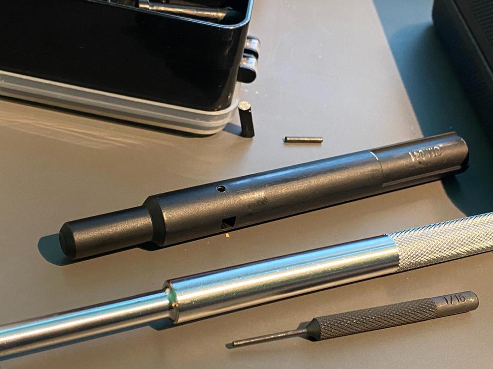

UPDATE:
Took it apart again and drove the pin out using a punch, it looks like it'll accept the guarder/JG replacement as the only CYMA one available is that abhorrent modern MLOK looking one off the platinum - cheers for the help @Hatchet

Didn't fit.
Even if it did - the way the pin would have to go through as pictured would have the handle facing the wrong way regardless, so - we're back at square one. Joy
Edited by pyromancer6
Perhaps reprofile it to fit in the hole then explore options for securing it.
Drill a shallow depression in the part and grub screw it from both sides. I'd bond the part in too.
When my boy slapped his mp5 handle off, we looked at it for a while, then tapped the tube, drilled and tapped the "knob" then cut a bit of stud to the right length, thread locked it into position and job done. He can hk slap to his hearts content.
