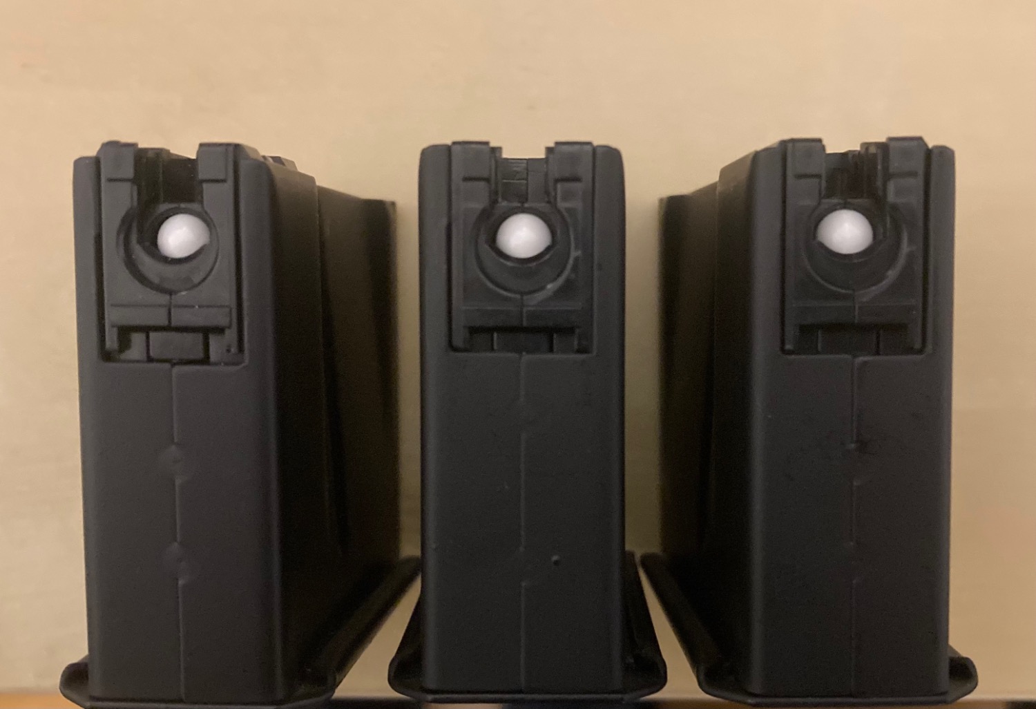

Not so far. If I put pressure on the bottom of the magazine, it feeds properly. As soon as I release the pressure, it doesn't feed at all.
Measure from the top of the feed lips to the bottom of the cutout which engages with the mag release. If it's different you'll need to shim the cutout with something. jB weld or somesuch.
Otherwise it's probably feed lips
Yeah sounds like the magazine isn't seating properly. When you apply pressure to the base of the magazine can you feel it move it all, is there any play in it?
Sounds like they aren't the same dimension to the mag catch. You'll probs have to pack it out but you should take measurements with calipers really
The feed sits higher on the mag that works (on the left) and has some spring to it (although, if I push down on it, the rear of the base plate moves). The other two do not have any movement.
Thanks for helping me with this.
It's actually quite a visually noticeable difference isn't it!
If you're handy with a tool, maybe take a bit of material off the tops of magazines 2 and 3 to match 1 on the Left?
Jacob, it's not excess material, it's more that the feed mechanism doesn't push up, like there is too much resistance for the spring.
