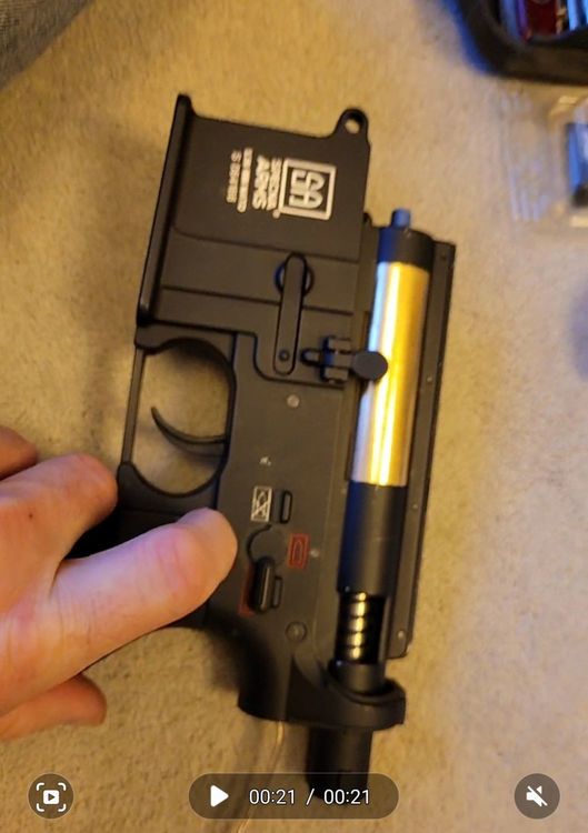

After the original upgrade advice of Hop rubber, nub and barrel I've swapped the hopchamber with great effect on my Specna H03.
Now dipping toe into the gearbox.... any advice on  cylinder upgrades, piston, piston heand and nozzle.  Trying to head around cylinder/barrel ratios with is "fun".
Running tightbore 6.02 363mm barrel.
Any pointers/advice welcome.

What's your current cylinder?  What's your spring and FPS? Might not be any reason to change anything, just because you can doesn't mean you should.  ?
Good job for actually thinking about the cylinder to inner barrel ratio though, generally for a 363mm you want a 3/4 or 4/5

Current cylinder is the stock specna.  Not taken gearbox it apart or opened yet..
Upgrade the M90 spring to ASG Milspec M105.  Hitting about 290FPS mark using .28's
Looking to achieve better consistency and accuracy than FPS.
