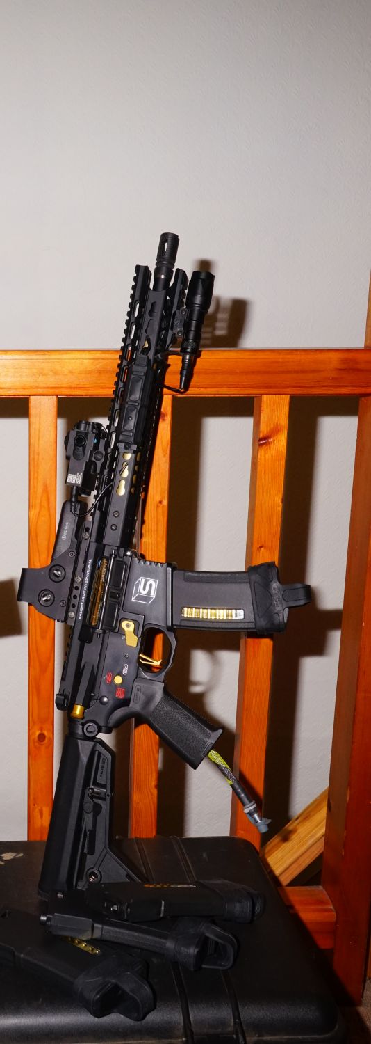

Unless anyone else here is able to put their numbers down (PSI and what kit used) here's a break down of what I have from tank to pew:
Tank: Guerilla Air Myth 68/4500
Regulator: Redline SFR
Engine: Polarstar Fusion Engine with S2 Lightning banjo, Red Nozzle and Red Low Flow Poppet
Hop up: Prowin M4 CNC hop up chamber (original version before they became crap)
Hop type: Kingdom of Airsoft R-Hop
Inner Barrel: EdGI 300mm length with diameter of 6.02mm
BBs: G&G or ASG Devils .28g BBs
With the exception of the tank and regulator, all the above fits into a G&P Salient Arms Intl M4 body. All in all i can run the above set up on 50PSI for 341FPS on .20g BBs.
Ill be honest, unless you are using a tiny 13CI tank or running and gunning everywhere, the likelihood of you running out of air is minimal. I have two 68CI tanks, I  find that one lasts me more than 1 day at sites where burst and semi auto fire is used. At one of the sites I play at where full auto is a given, one tank will last 3/4 of the day but I normally change mid way through.
Below is a pic of my HPA M4
