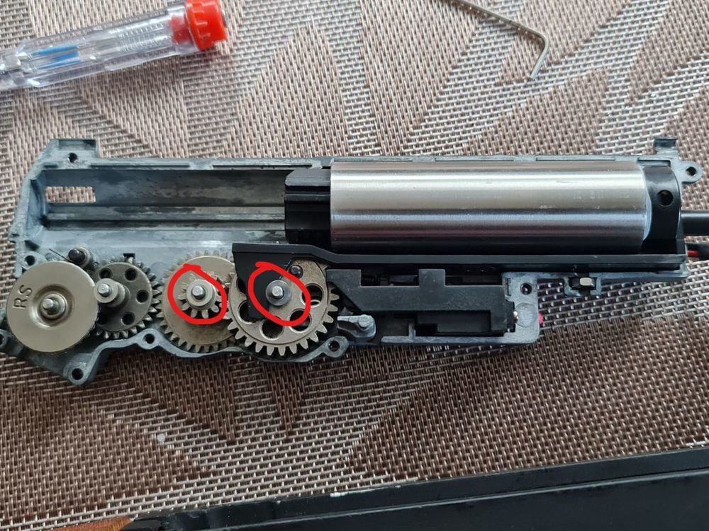

Title says it all really, I have a Real sword SVD in bits every time I try to get the gearbox back together the tappet plate pushes up on two of the shims, this is due to tappet spring not having any guides and just being 'wedge' fitted so every time I try to mount the gearbox back the piston rides up and hits the tappet plate causing the spring to pushing it up further.
Its frustrating as hell and wasn't sure if there was a trick or tip I am missing, thanks in advance, I'll upload some pics as well
these are the two shims as you can see the tappet sit just under one and the second usually get knocked off in the process
Try a tiny bit of grease on them and stick them to the bushing on the other side of the gearbox.
Hi, I push and hold the nozzle back a short way , to hold the plate back and clear of the shims, as I'm putting the cover back on, then once a couple of the cover  screws are in place, you can release the nozzle..
You need 4 hands!
