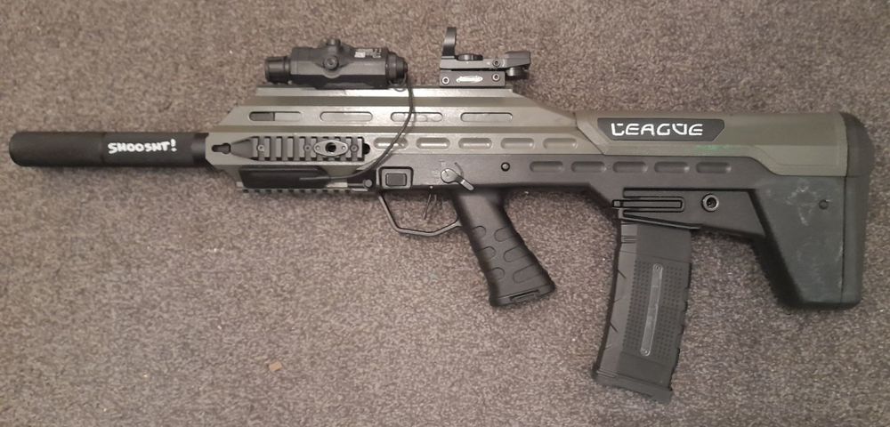

Firstly, I've added a 200mm CYMA suppressor which changes the "crack" of the pellet leaving the barrel to a dull "thud" and looks a bit more space-marine-beefcake, along with a basic RDS and faux-PEQ (actually just a very bright LED lamp). Also I've used my favourite Halfords OD paint and lacquer for a distinct two-tone OD and black scheme which matches my loadout and added some markings with white permanent marker. I'm currently using 380rnd Battleaxe hicaps with a useful capacity check window which, along with most other mags, work a treat following a mag well mod - more on that later.
What's with the "league" markings? A nod to my favourite computer game back in the day, Colony Wars: Vengeance and the logo of one of the factions in the game, the League Of Free Worlds, which I also have on my brain bucket and tac vest; tragically sad and geeky according to Mrs. Goode. I'm not going to argue.

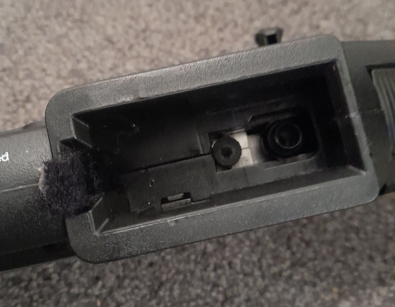

Secondly, the mag well mod; the UAR is notoriously picky due to an awkwardly-designed magwell, the one flaw in am otherwise excellent design IMO. I dremelled away the pointless spring-catch at the top of the mag well which pushed many mags out and caused them to fail to feed and added a strip of velcro at the rear guide to improve the mag fit. Have tried various mid and hi cap designs and all fit and feed perfectly well now. I'd say this is a must if you are going to have any hope of using STANAG mags other than the ludicrously expensive and hard to find U-Mags supplied with the gun.

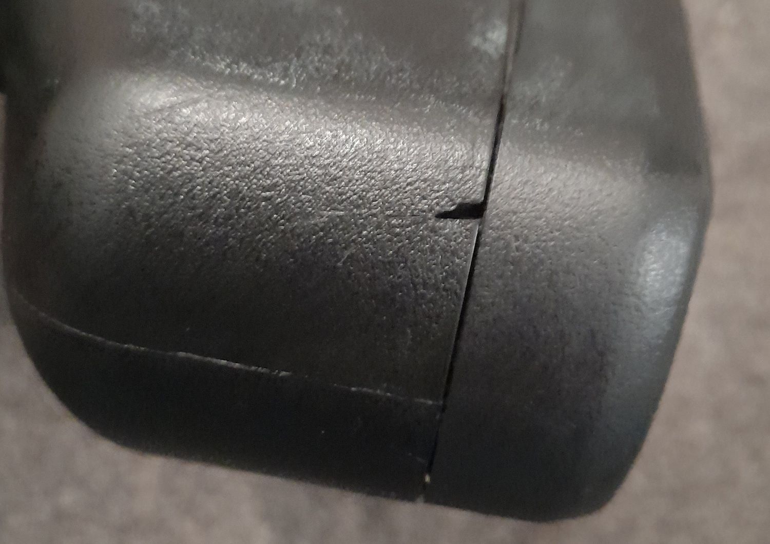

Construction-wise is mixed; it's well enough put together, the internals seem solid enough however the external plastic isn't the best and a chip/crack has developed at the butt. That said its survived various skirmishes, collisions with trees and vegetation and being slung roughly in my motorcycle rucksack when being transported to and from skirmishes so it's holding up enough, however the cheap feel to the external plastics is a reminder that it is a budget gun so probably best not to fling it about. The one thing that us very positive is its very easy to take apart and put back together again - useful for maintenance. The gearbox also has a quick change design for the spring, another highly practical and useful feature, one of the many of this gun.
