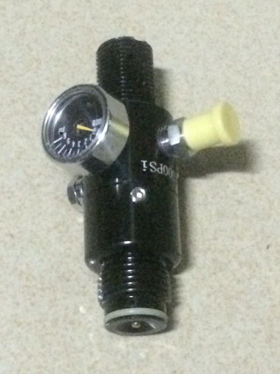

I have bought an air regulator and air bottle for air soft gun, but I do not understand much of the topic.
  1. How to install it?
  2. I have no seen any hole for air flow out on the regulator, how can I use it?
Yes, i know that i bought it on aliexpress, the only reason is because this is the only place that is cheap enough and be able to to ship to my country.

The regulator is upside down in your photo. The threaded end at the top of the photo should have some gaps in the threads - that is a safety feature so that if it somehow begins to unscrew while under pressure the air can escape safely before the regulator flies off
Screw that end into the cylinder
Do not use any thread locker - just screw it on
You should tighten it to a specified torque - if the documentation and markings are there then the cylinder and regulator should have a torque setting provided
If all is good then you fill it using the nipple under the yellow cap
The end that we can see has a pin in the centre. That is the pin valve which will release the air when in use
To use it for airsoft you will most likely need a remote airline with the appropriate connections on either end
Depending on the gun you will be using, and the output pressure of the regulator you will probably need another regulator to step down to the guns working pressure - check out the other threads on here about HPA systems
