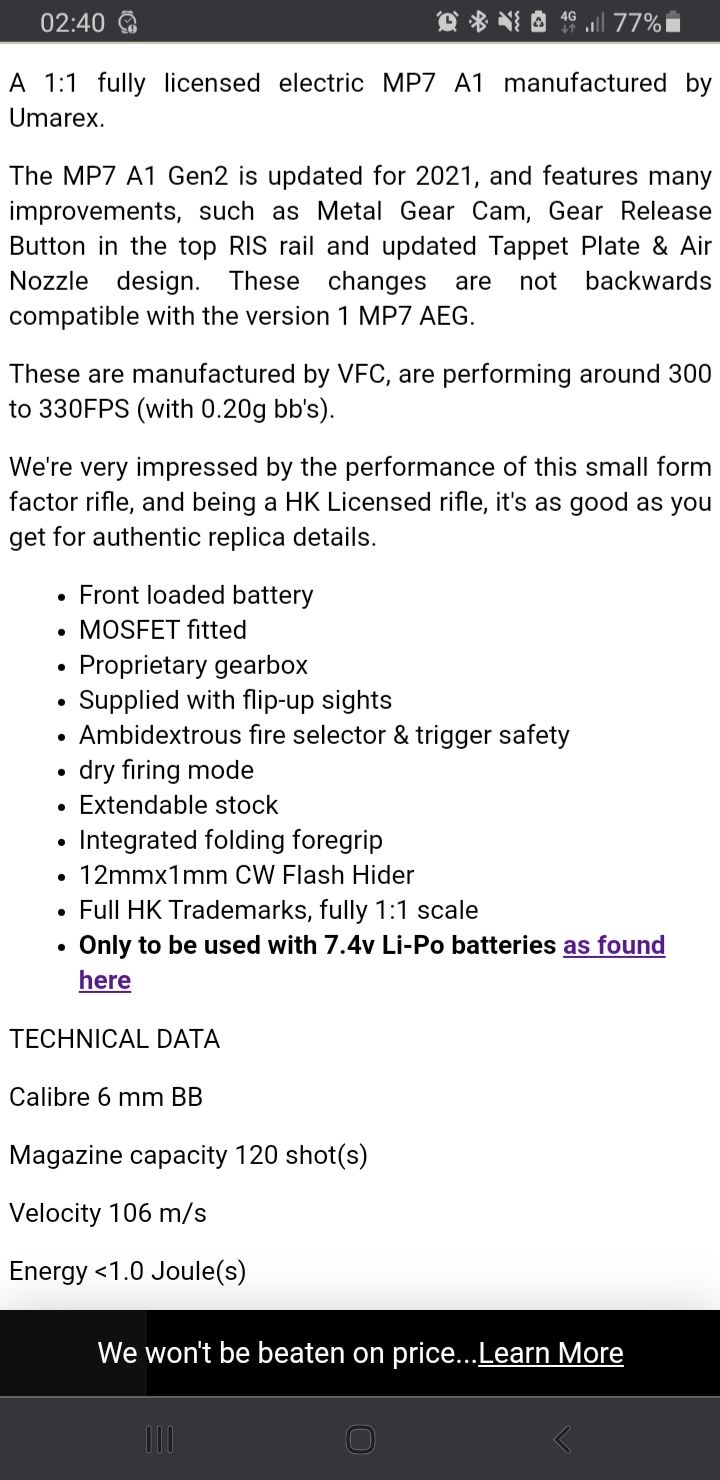

@Mr. No_Face I ordered it form Land Warrior. It just arrived and works fine. It does however come with some paperwork that shows it only shoots at 303fps and to only to use a 7.4v Lipo. I suspect they might have detuned it, and recommend to use a 7.4v to avoid having to repair it under warranty. Later I'll chrono it and as its got a quick change spring I'll pop it out and have a look at it. If you want mags the only place I found with stock is powair6. They also do the rails and 12mm cw to 14mm ccw adapter.

@Mr. No_Face It's a gen 2 and does have the release button. I think the import version shoots a little hot at around 370fps. I've had a look at the spring and its very short and stiff. Looks like I'll have to cut down a few different springs to try out. With it running at 300fps I think a 11.1v might risk premature engagement, so I'll wait until its upto 340fps.
Yea if you hit 300-ish fps (mine from LandWarrior goes 310) it double cycles on semi every few shots. I have literally same issue with my ICS guns that were downgraded to UK market tad bit too much. I run mine at 7.4v for now since I have more of these that fit the damn thing to begin with but after I get apropriate spring to get it to 345-350 range I would probably swap to 11.1v and see how it goes. For now it sometimes can lock up on semi if you spam the trigger - needs to swap into full auto, fire a burst and can go back to semi. With cutoff on empty I never know whether it locked up or just need to reload since mags are quite tight (if you load them full the bendy joint follower can get stuck and you need to disassemble the whole magazine... I personally run them at 90rds)
