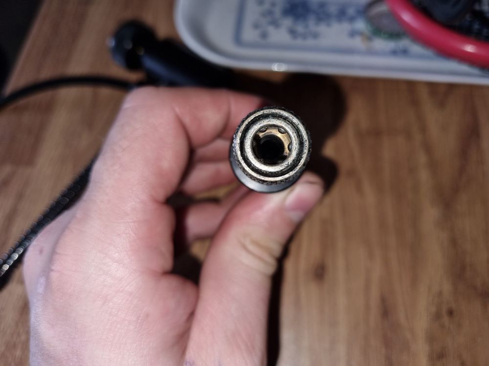

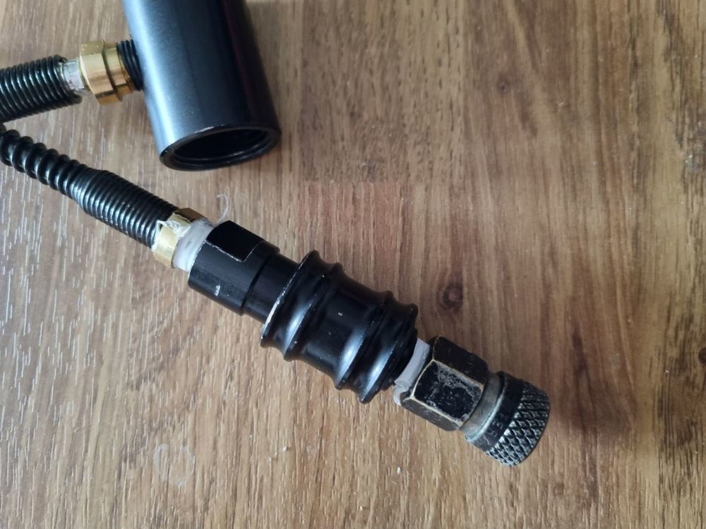

Yeah, its leaking from the final connection.  I stripped the line down and PTFE taped all threads, and when line is pressurised but not connected to the gun its fine, but if i connect it to the gun, even with the spare union fitted, it leaks.
I even took the circlip off and stripped the slide check to make sure it wasnt an o ring inside gone, and there were no burrs on the slide check body or nicks in the o rings.
Im just annoyed that the coupling and line have only lasted me 3 or 4 game days... i would expect the line to last longer than that...

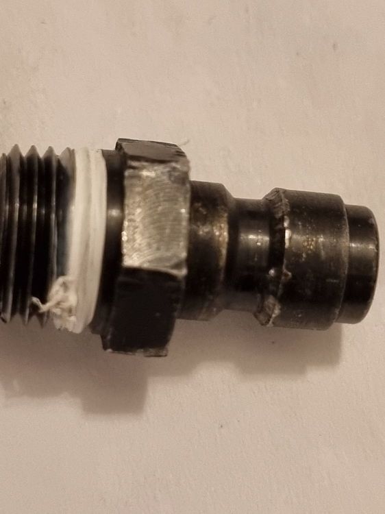

Plus i have no idea why the union on my gun got such burrs from the connection on the line. (Photo included for ref)
That wear isn’t a problem in itself.
The metal of the male nipple is softer than the metal BBs in the female socket.
((Unless of course it gets so bad that the connectors don’t match properly))
This would replace your socket
https://palmerspursuit.com/products/female-disconnect-to-1-8-npt-foster
But there may still be just a small o-ring inside the female socket causing the problem. If it’s still in situ then consider a little grease or oil* on it to help the seal. It will be the one at about 0:30 in the video below
* not WD40 etc as it could eat the o-ring and make the problem worse.
Ideally use something silicone based.
Noting that oil and high pressure air should not be mixed.
Keep oils away from the 3000psi inputs of the cylinder as that risks contamination inside and a potentially very nasty flash fill failure accident
Output pressures can have appropriate lubrication on the fittings
aha...    having watched the video again (when not half asleep after work)  it looks like the problem is that i am missing the o ring inside the final connector...   will try and source a new one and try again over the next week or so
