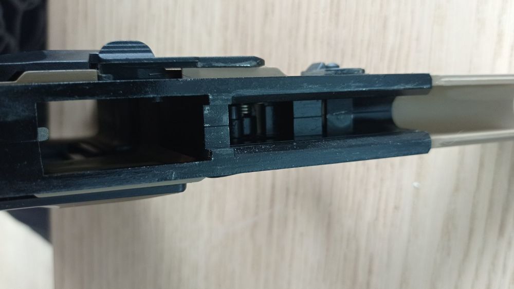

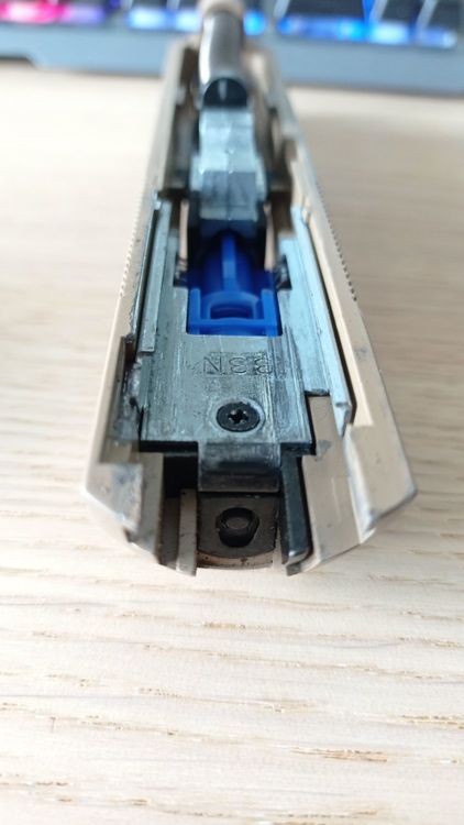

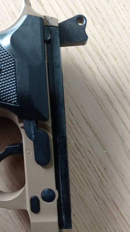

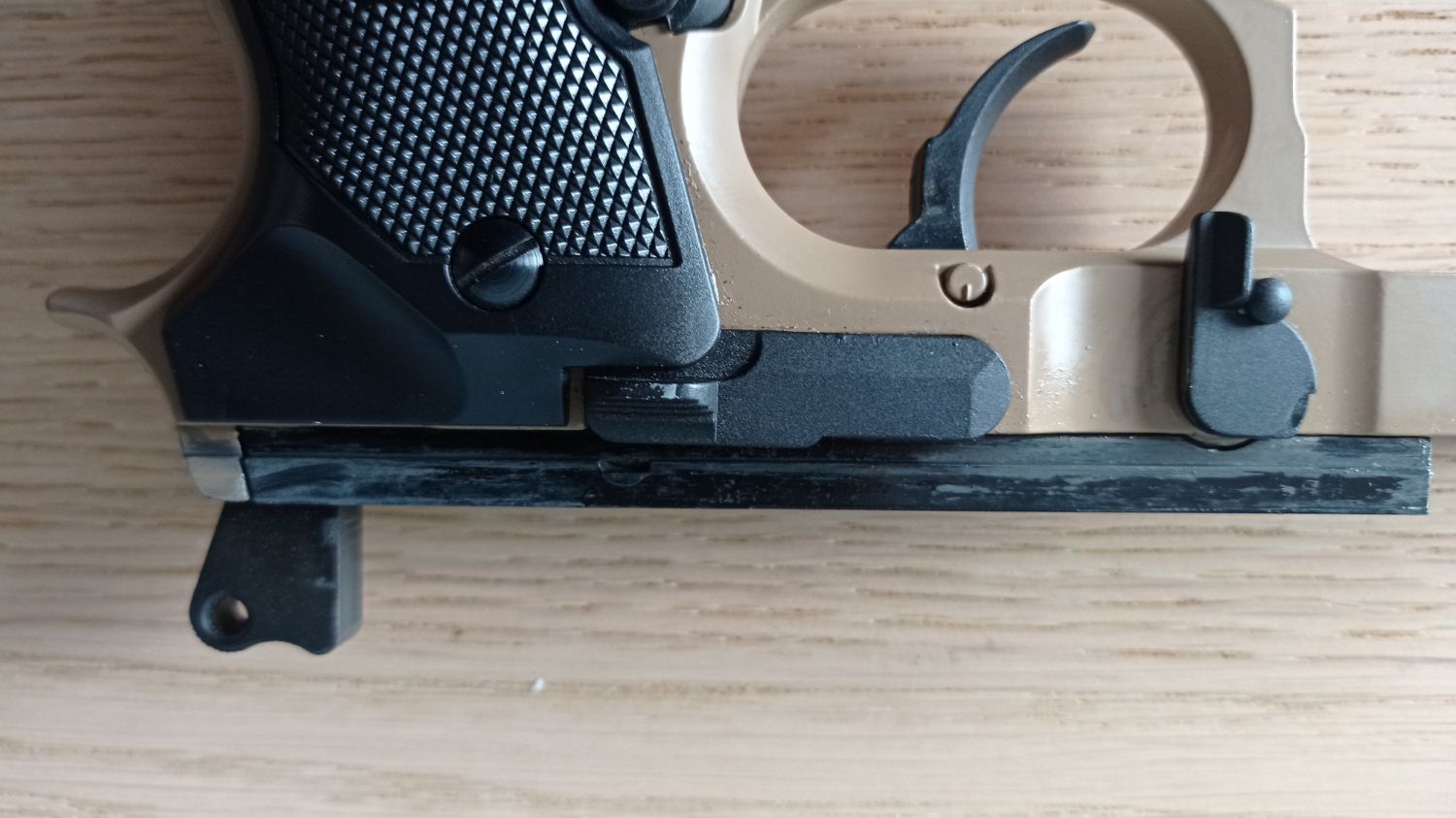

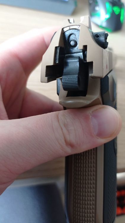

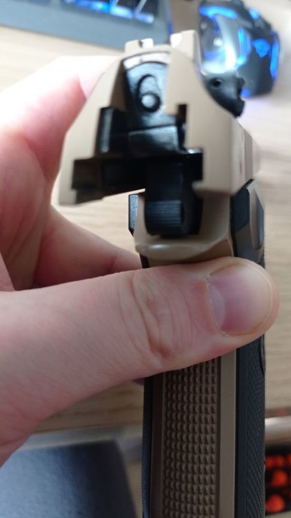

I see that only the hammer is getting stuck a little when I'm loading the gun but that doesn't seem to be the problem as it shoots like 10 BB's with no issue and then it starts shooting weirdly.
Ok, I ordered brand new CO2 mag to try it out. I will post a short video later so we can basically see where the issue might be. I should get it on Thursday so awaits a video on that day.
