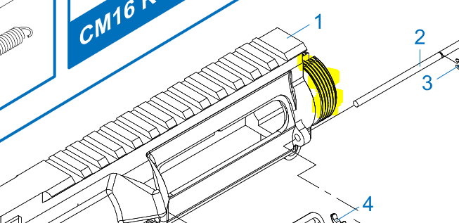

@TomFarrington97 It should be standard AEG threading underneath the rail judging by the R8-L parts diagram.
Remove the upper from the lower of the gun - remove the inner barrel/hop unit.
Then you remove the upper and lower set-screws(2) and slide the rail off:

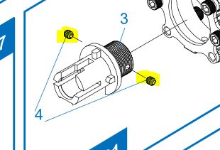

Then remove the outer barrel by undoing the two grub screws(4) on the silver barrel stub-thing:
Then you need to remove the barrel nut (1):
Once done, the mounting block (2) and the outer barrel stub-thing (3) can be removed. Problem is, that barrel nut needs a special tool to remove, or a bit of lateral thinking...
According to this old thread - you can use Allen keys wedged into the barrel nut to remove it.
If you or any of your friends have a 3d printer, you can print this to remove the nut.
One the nut is removed, the mounting block/outer barrel stub will come off, and you are left with standard threads:
