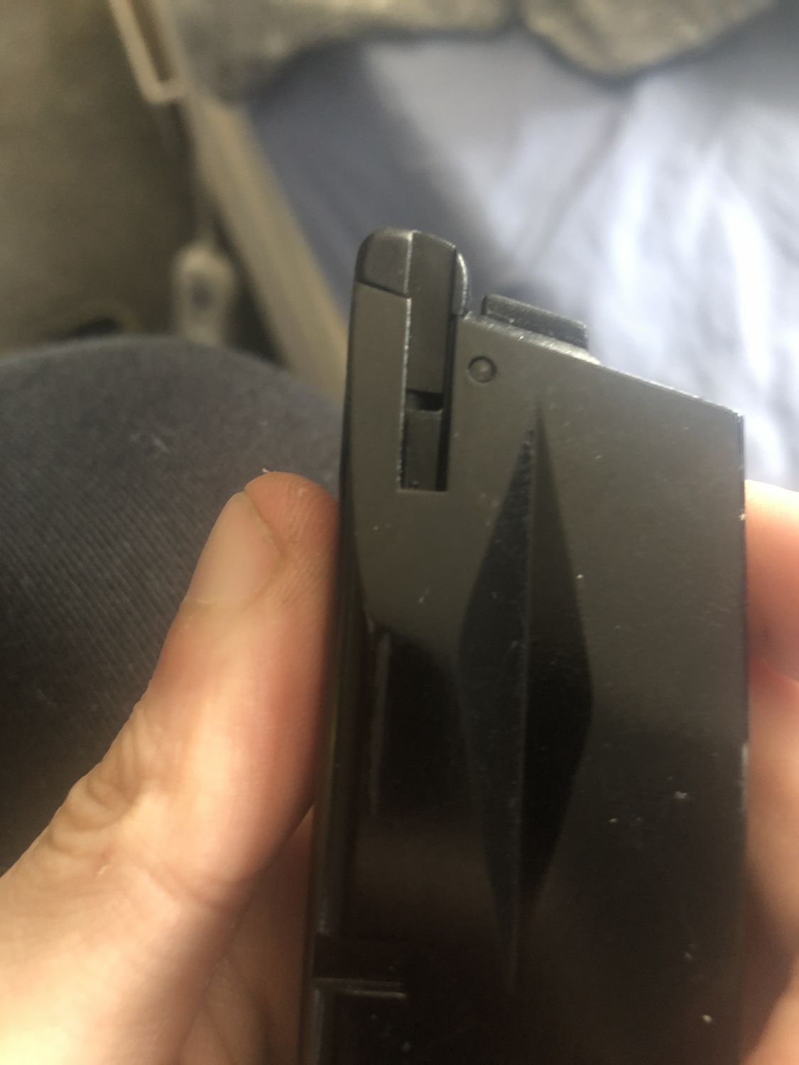

- The slide doesn’t lock back when empty 90% of the time. I think this is due to the mag follower but I’m not too sure.. with the slide off, I can see the mag follower engages the slide release lever, but with the slide on it usually doesn’t.. mag problem or a weak spring inside the switch on the pistol do we think?
Added a photo of the mag - from images I’ve seen online the gap shouldn’t be that big, but I’m not so sure, doesn’t look damaged or anything so my thought is a weak spring in the slide release lever?
Yes the safety/decocker also engages the semi/auto function so it must be stuck in the medium position.
Yep that's the same gap I have on my 2 mags which both lock the slide properly.

Perhaps that's not the same manufacturer magazine so no 100% compatible?
