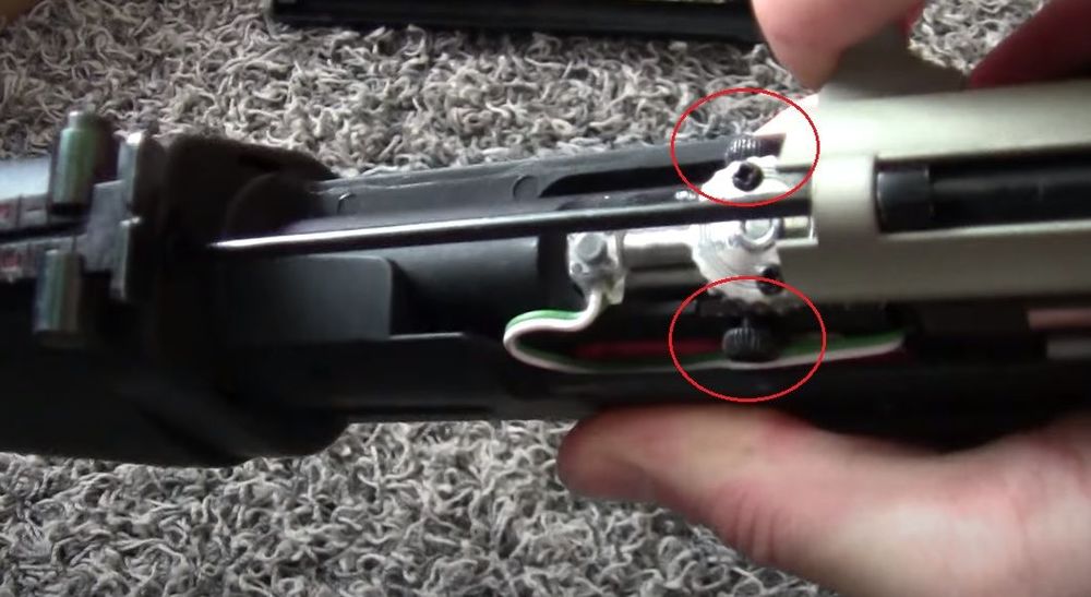

The Real Sword, CYMA and S&T (the latter two being copies of the the former) have a poorly designed hop system.
The hop unit itself is not great as the dial wobbles quite a bit, but how it is retained inside the barrel sleeve section that extends into the receiver is a complete joke.
There are two finger tightening screws that act like grub screws on either side of the sleeve, they thread through to the hop unit and keep it in place - there is a spring behind the hop over the inner barrel that pushes the hop unit into the gearbox, however I found if you let it go all the way in the nozzle wont pull back far enough to let a magazine feed, but if you tighten it at a point too far out you'll have massive air leakage and fps drop off - i found the correct distance that the two screws need to be tightened is about 1-1.5mm out of full engagement with the gearbox.
Try experimenting with engagement distances (how far the the GB goes into the hop unit) this could be what is causing your issue.. perhaps the nozzle is a little too far out.
