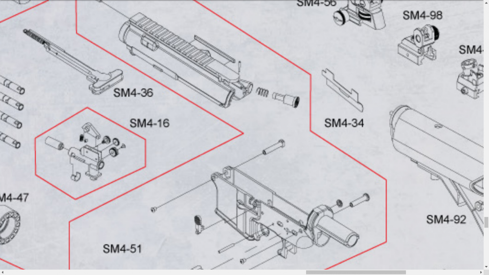

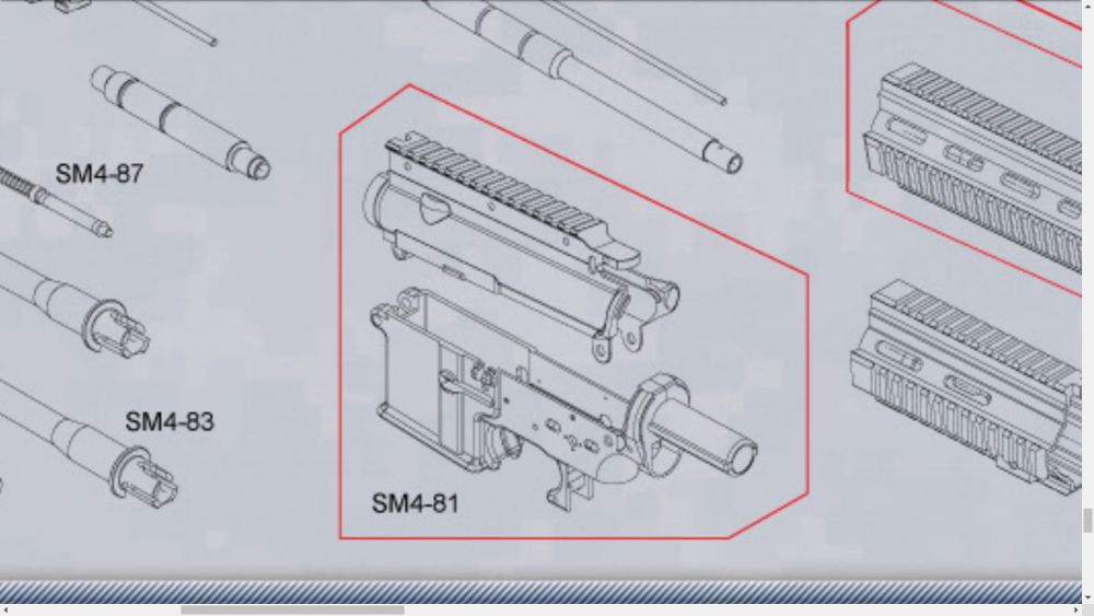

and as it is the SR4 series, the only generic manual I can find is this...
https://www.unit13shop.eu/download/SRC-SR4.pdf
which seems to show a LOOPED SM4-81 receiver on left...
(416 type maybe)
and perhaps a more regular receiver SM4-51 on right
So it seems you might need to strip the gun, remove grip, all pins, don't forget tiny pin AND mag catch etc...
clear wiring ensure it is all free etc...
then slide slightly forward & up and it should separate with box perhaps like video shows
if does - it is a bit of a wank just to get into the gun ffs & if looped would be a big wank to change hop/bucking

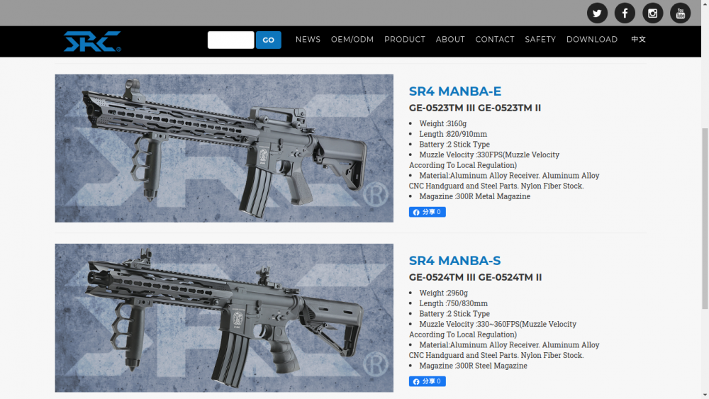

2043921825_Screenshotfrom2020-10-0301-54-53.thumb.png.ecf6ab22e6cef6455654991de6cb90d6.png18377357_Screenshotfrom2020-10-0301-55-23.thumb.png.d596cb7636d3c6f5323aba59b1de413a.png
oddly enough - SRC can't even get the name of their own gun correct...
it is the MAMBA as in snake, but they keep referring to it as the MANBA instead of MAMBA
I'd be concerned if the company can't even get the friggin' name of their gun correct on their own site
(makes you wonder what else they made a pigs ear of inside)
