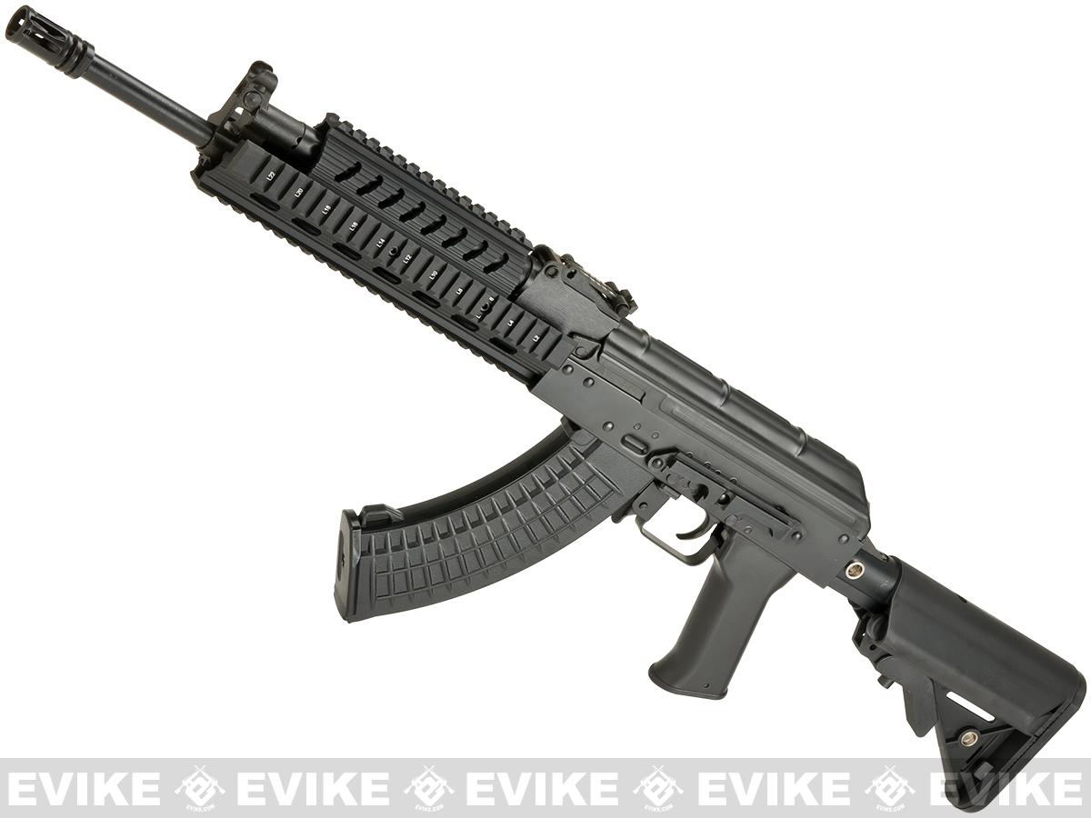

alsknvfvnzikusg Posted April 2, 2018 Posted April 2, 2018 hi, i ordered an LCT TX-MIG AK and in most videos ive seen it has a firerate of over 900, if i wanted to keep it around 750, what kind of battery voltage do you think i should use? it uses the new ver 3 gearbox
Supporters Sitting Duck Posted April 2, 2018 Supporters Posted April 2, 2018 15rps Vs 12.5rps is not worth worrying about If a gun shoots too slow there is a chance you release trigger too early cutting cycle early and trigger locking in dead zone with cut off leaver still half raised on old school triggers Trust me, a couple of rps is nowt to worry about Stay on small tamiya, low capacity/burst lipo and you won't be going too quickly
alsknvfvnzikusg Posted April 3, 2018 Author Posted April 3, 2018 actually its more like 1000 or above, still no advice regarding lower voltage batteries, or anything else regarding decreasing fire rate?
Supporters Sitting Duck Posted April 3, 2018 Supporters Posted April 3, 2018 2 cell LiFe battery - though this might be starting to struggle cycling from still 7.4v Lipo (8.4v fresh off charge) 6.6v LiFe (7.6v fresh off charge) Other than that fancy mosfet or burst mosfet or plug/play avacado Or a very high torque 28tpa motor or above = frankentorque - that will be slow rps TBH - can't see why you are worried too much Gunfire tested a LCT STK-74 on 7.4v at 416fps shooting just over 600rpm So if some others are saying 1,000rpm what fps & what battery are they using ??? go to 2:00 for chrono stuff most stock guns shoot about 12/13rps out of box on a 7.4v some shoot a bit quicker if they got a quicker motor (say 15rps on 25k motors with average 7.4v) if you got a clip of it shooting quite quick I'd check they are not running it on 11.1v Often UK spec guns, a 7.4v will often do a lightly tweaked gun to get to 20rps but stock/average performance most guns will struggle to get 15rps out of box 7.4v
