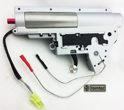

looks like one of them QD spring boxes from say TomTac or HelmetWorld (snigger)
did it have a micro switch trigger ???
Image result for tomtac v2 gearbox
reckon best bet is pull trigger, keep front of box down and with a large screwdriver
lever at the rear just under spring guide area, sort of forward & upwards slightly
