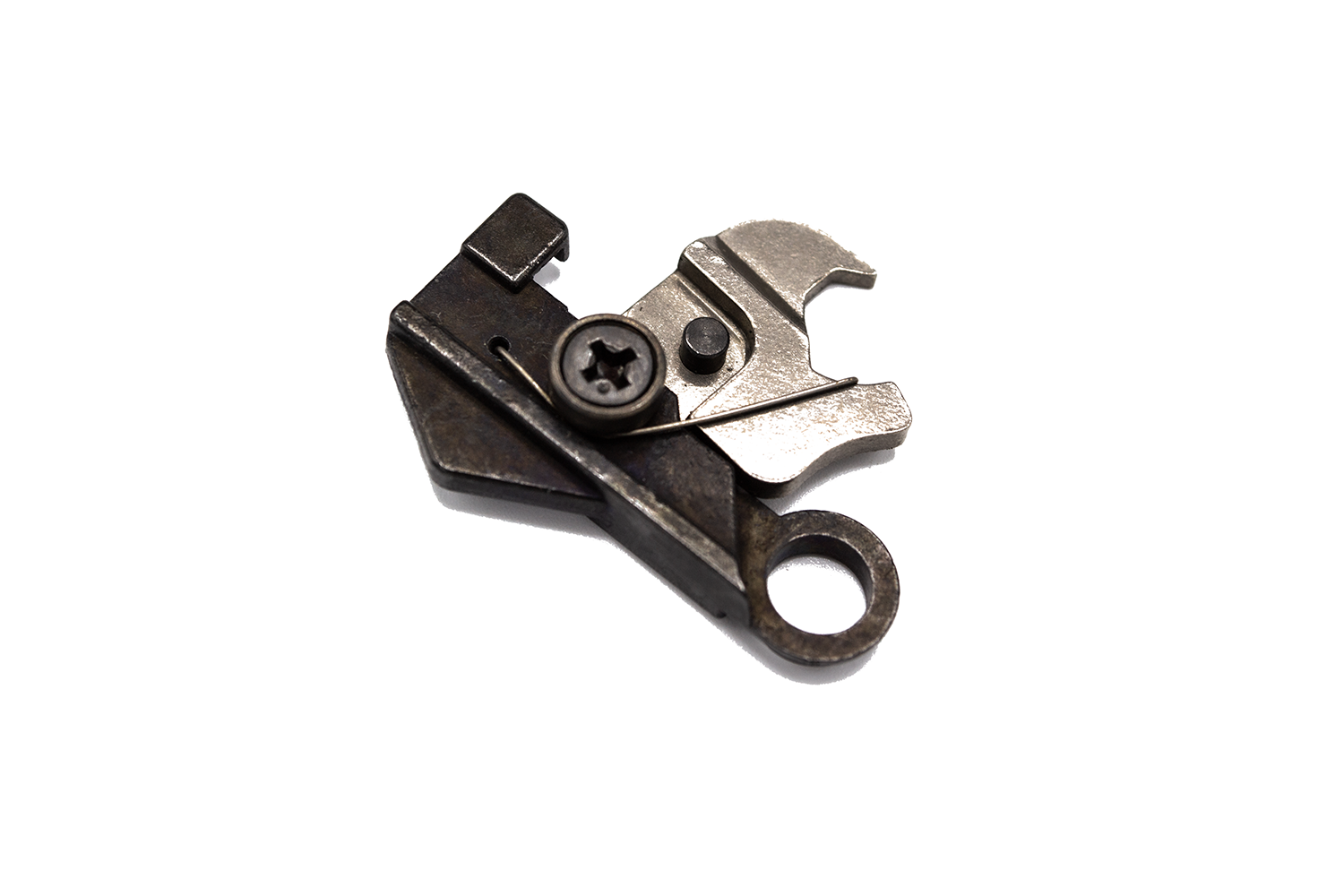

Karinexmachina Posted 12 hours ago Posted 12 hours ago Hey there i was wondering if anyone else encountered issues with the 93-R where the single shot option simply doesnt work? it fires in full auto at times on single but the 3 round burst setting works fine
Lyndication Posted 12 hours ago Posted 12 hours ago The semi-auto disconnector has work out or broken. It's pretty common on a lot of pistols. The burst option has its own little system that works with the hammer. You'll need to open up the fire control and check to see what's what.
Karinexmachina Posted 12 hours ago Author Posted 12 hours ago I'm not sure what i'm looking for the 93-R has alot going on
Karinexmachina Posted 12 hours ago Author Posted 12 hours ago do you mean this piece part 24s that interacts with the slide? I don't know much about these honestly
