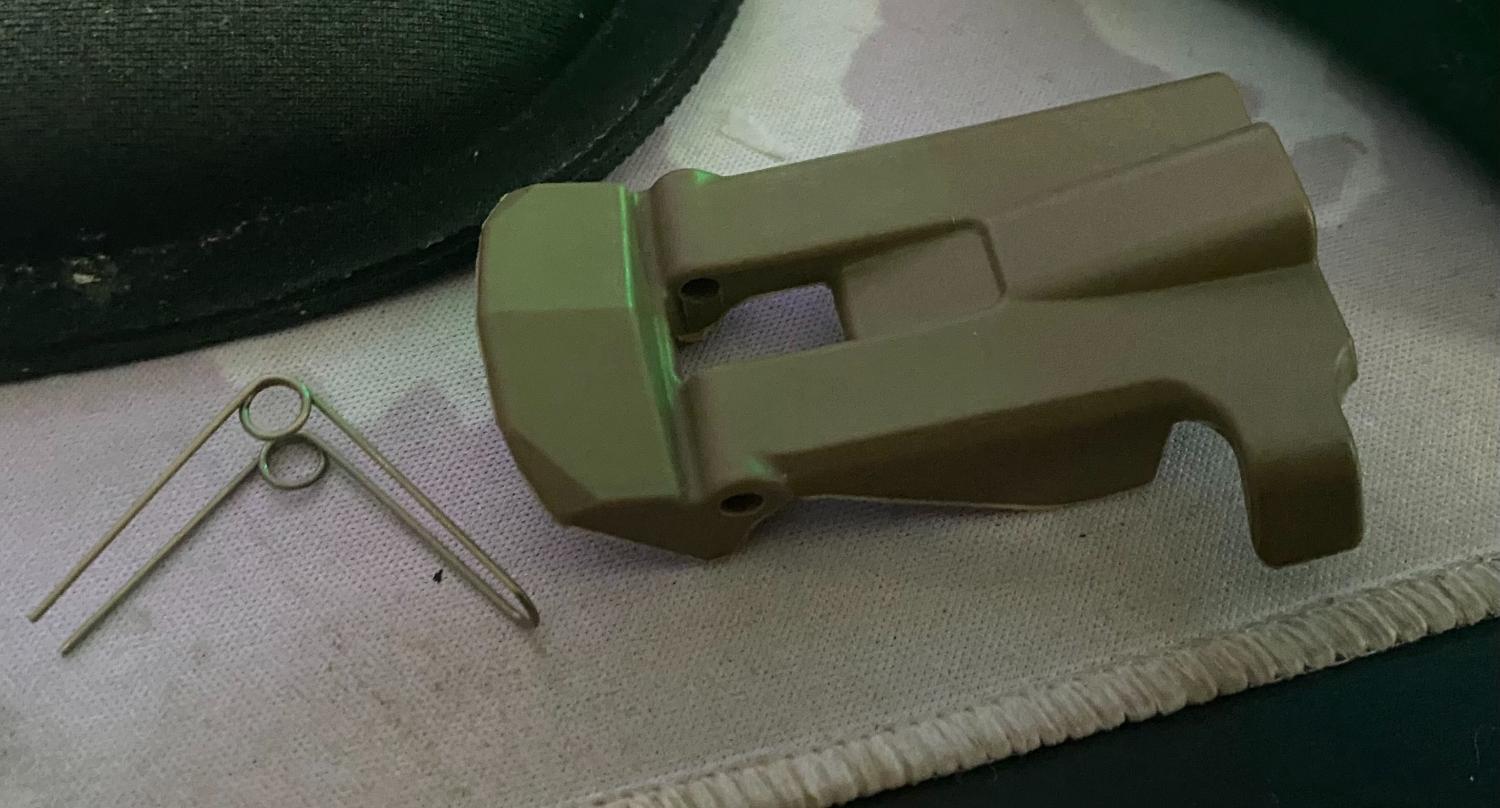

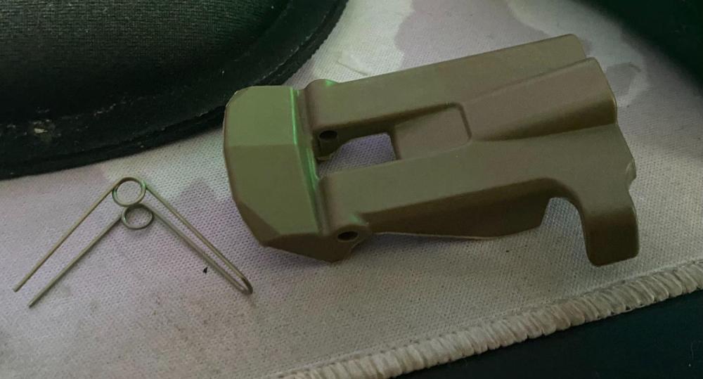

Austeyr Posted 23 hours ago Posted 23 hours ago My WE Glock 17 got stuck in the holster, I had to remove this part to get it back out: However I can't work out how the spring sits correctly. Anybody have any idea?!
Austeyr Posted 22 hours ago Author Posted 22 hours ago Managed to fix it. In case anybody else runs into this issue: The looped part sits in the recess, the two arms need to be bent over so they sit on top of the looped part and then the whole block slides into the holster. It's very fiddly. I ended up using an m4 AEG trigger pin to hold the spring in place so I could bend it over and then knocked said pin out with the main holster pin ButcherBill 1
