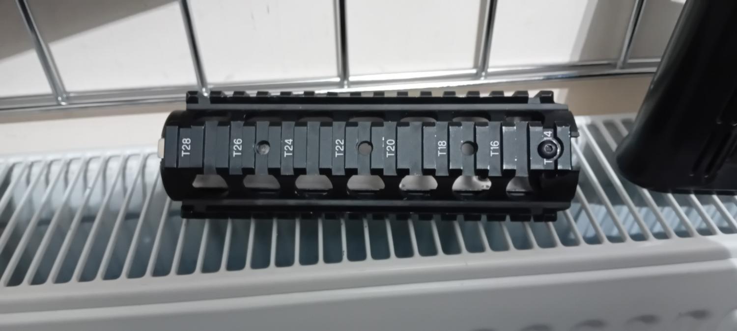

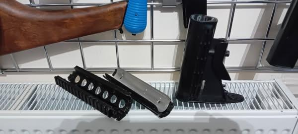

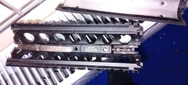

I reckon it's the TM rail I sold him, here are some pics...
Nice clone that with the front and rear clamps.  Just need to know about his tm now , old school or recoil
