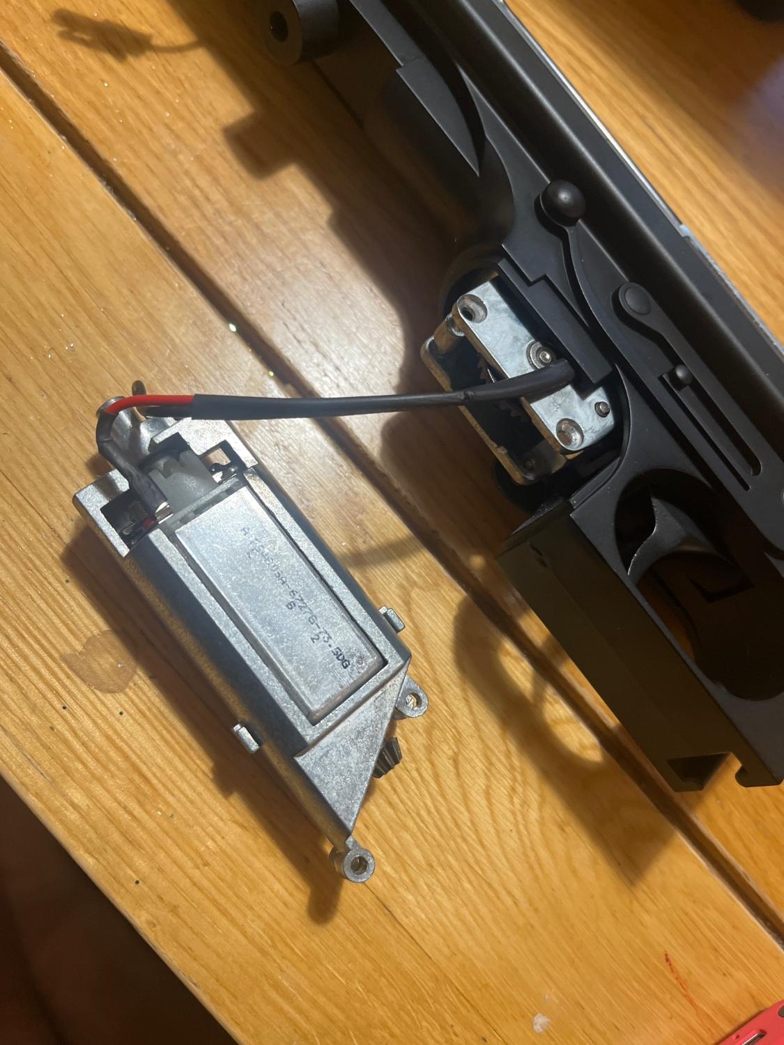

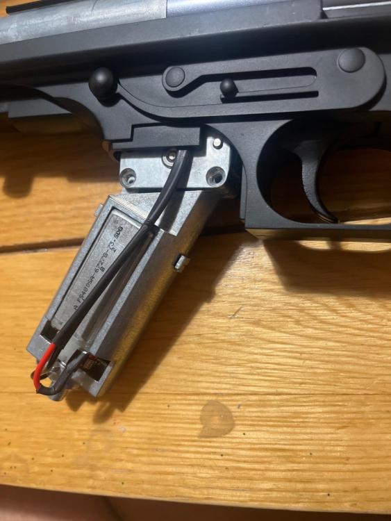

Cooperman26 Posted October 6 Posted October 6 (edited) My god! Stress levels 100000x fitted the wood kit, a few amendments needed not an issue. Plug her in, ran a few mags no issues. Then just went dead. Took her apart, checked the fuse, checked the connections, no issues, took the motor out where it sits plugged in, Pew pew! Awesome! Screwed motor back into place, attached battery, NOTHING. Took the motor back out, tested again, ABSOLUTELY FINE. Put it back in position, DEAD. Did this numerous times. Am I missing something blindingly obvious!? Edited October 6 by Cooperman26

EDcase Posted October 7 Posted October 7 (edited) That indicates there is a short in the body. Do you have a multimeter? If so check continuity between the body and each motor wire. Edited October 7 by EDcase
Cooperman26 Posted October 7 Author Posted October 7 3 minutes ago, EDcase said: Sounds like a short in the body. Do you have a multimeter? If so check continuity between the body and each motor wire. I don’t 😭 it’s now working when in the pistol grip position. But as soon as I screw it in half way it again stops. Won’t lie, it’s giving me a headache 🤕
EDcase Posted October 7 Posted October 7 (edited) Hmm, that IS strange. What do you mean, 'screw it in half way'? What about if you pull it out slightly so the screw holes don't line up? Also try moving the wire with each trigger pull. Edited October 7 by EDcase

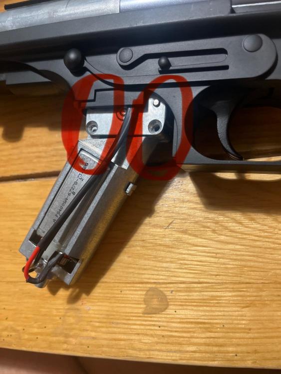

Cooperman26 Posted October 7 Author Posted October 7 4 minutes ago, EDcase said: Hmm, that IS strange. What do you mean, 'screw it in half way'? What about if you pull it out slightly so the screw holes don't line up? Red circles, the main screws to keep it into place. As soon as I go over half way into them, it again dies and nothing happens. Take them back out and sit motor in place and it’s fine. 😩
EDcase Posted October 7 Posted October 7 (edited) Yeah, that could be the problem I mentioned of a short in the body. With the motor in place try pushing the main wire around to see if that makes a difference. Edited October 7 by EDcase
Cooperman26 Posted October 7 Author Posted October 7 39 minutes ago, EDcase said: Yeah, that could be the problem I mentioned of a short in the body. With the motor in place try pushing the main wire around to see if that makes a difference. No difference. And now the motor isn’t working at all 😩 than you for advising though!
EDcase Posted October 7 Posted October 7 (edited) I think there is a break inside a wire. You'll have to open it up to find where it is. It would help a lot to have a multimeter. You just need a simple one. They are quite cheap and easy to use for your needs. Edited October 7 by EDcase
Cooperman26 Posted October 7 Author Posted October 7 7 minutes ago, EDcase said: Unfortunately it seems to be a problem with the wiring. I think the plastic of a wire has been damaged so it's making contact with the metal body or another wire. You'll have to open it up to find the damaged part This is what I was hoping wouldn’t happen 😩 but I think you are correct. EDcase and HZR13 2

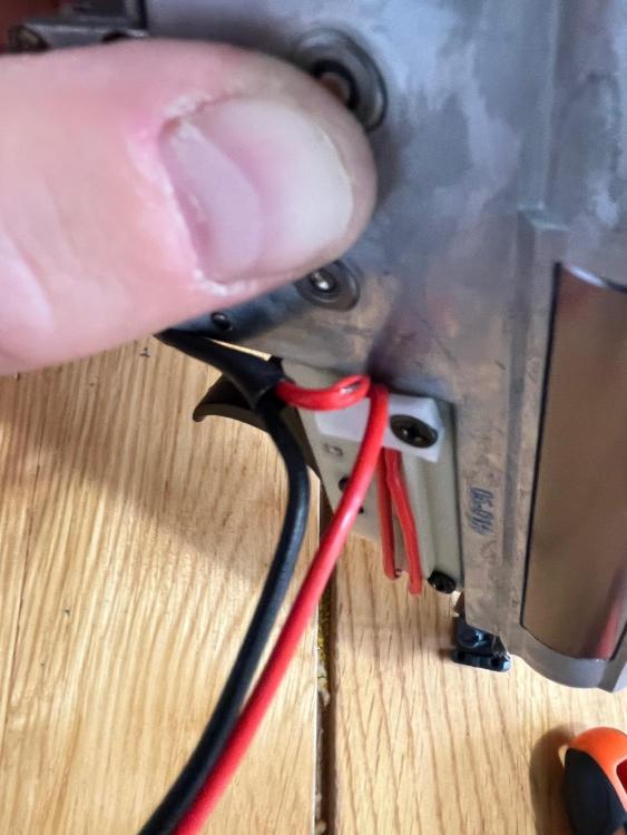

Cooperman26 Posted October 7 Author Posted October 7 I have stripped the whole thing. Cleaned the connections whilst I was in it. I was adamant no issues with wires… then this sneaky little thing caught my eye as I was putting it back..
Cooperman26 Posted October 7 Author Posted October 7 Fingers crossed! Although I’ve now lost the teeny tiny plastic bit that sits in the store selector dial that pops into the little hole hahaha! Couldn’t write this. EDcase, HZR13 and Austeyr 2 1
EDcase Posted October 7 Posted October 7 Nice find. A drop of super glue should sort that out. Give it a test of course to make sure that's the only damage. The harder problem to find is if the metal wire inside is broken but not the plastic sleeve Cooperman26 1
