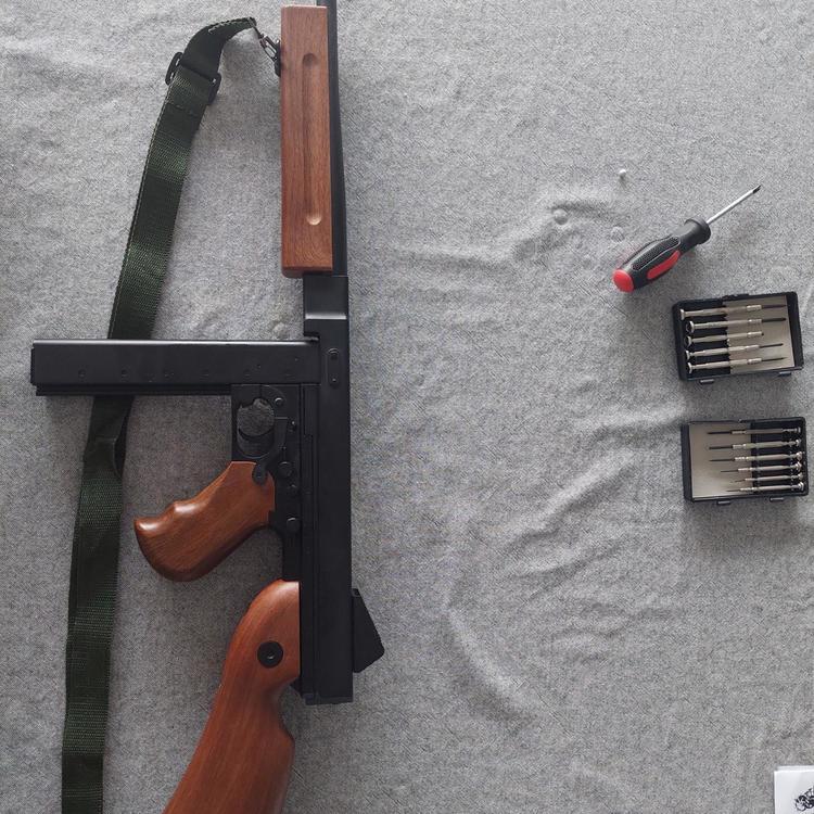

Hello
I bought an m1a1 thompson from snowwolf 3 years ago with a battery. After 2 years it kept jamming up. I went to an airsoft store to fix it. They said they changed the motor. I tested it and it didn't work. When I pull the trigger it clicks and doesn't shoot. My battery is an NiMH 8,4V 1100mah battery. I think it's because the battery isn't strong enough but I'm not sure. Can someone help me fix this problem please?
With kind regards
Ruben
Yes, its likely the battery isn't powerful enough.
Look for a 7.4v LiPo with the highest mAh (How long it lasts) and C (Max burst power) rating you can find that will fit in the battery space.
All the usual places I would look (Turnigy/HobbyKing/ComponentShop) seem to be out of stock 🙄
But remember you'll also need a decent charger to make sure charge is optimal.
Do a search on the forum as chargers have been discussed before.
Also consider changing connectors to DEANS (T-plugs) for best current flow.
EDIT
THIS battery should work (check size)
THIS charger (or similar) is the most basic
THIS charger is good and a good price but note that it needs the DEANS connector on the battery.
