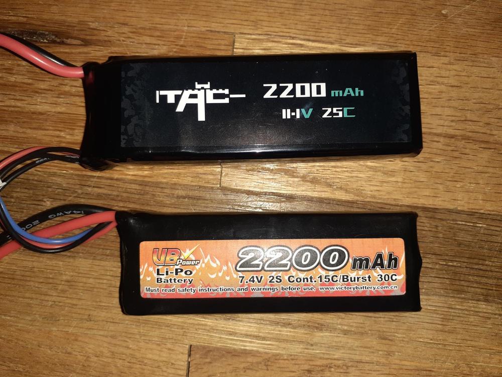

I have a stock classic army m249 mk2 and was wondering if a 2200 mah 11.1v 25c battery is too powerful for it?  I test fired it with the battery and it shot way faster than with my old one(a 2200 mah 7.4v 2s cont. 15c/burst 30c) so was worried that it will burn it up.  Is that a possibility since it is the original motor?  Any input is greatly appreciated and thank you for the help!

Ok, thank you!  I was getting around 6 bbs a second with the 7.4v one and I felt that that was plenty.  I bought the 11.1v a little while ago since the old battery I have is pretty puffy.  I didn't notice that it said 11.1v when I got it and hadn't compared the two until now.  I'll have to get a new battery then since I can't afford to replace a bunch of parts so thank you for the information!
