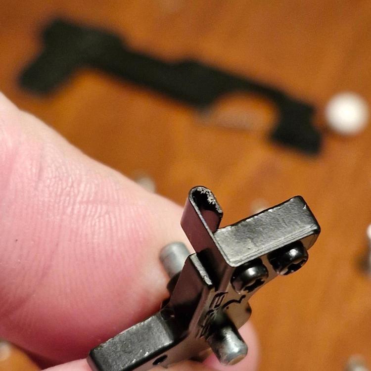

Hi all, started to fit the above to my G&G CG16 today. The actual board went straight in but I can't fit the magnet holder to the trigger as it, the trigger, is the wrong shape.
Has anybody come across this problem before and how did you sort it? It doesn't look like I can make it fit so I'm presuming I'll need a new trigger.
Pic attached to show the top of the trigger.
You will need to get a standard M4 trigger.
@DanBow did you sort the problem. Im facing the same issue..what did you do?
Completely forgot to update this!
Bought a standard m4 trigger off patrolbase and it, pretty much, all slotted together perfectly. It's back to shooting like a dream.
Excellent!  I am glad it went well.  I did the same with the G3 trigger when I fitted a Hybrid.
That's great pleased you got it sorted...I was hoping you said that as I too bought a M4 trigger..waiting for delivery!
