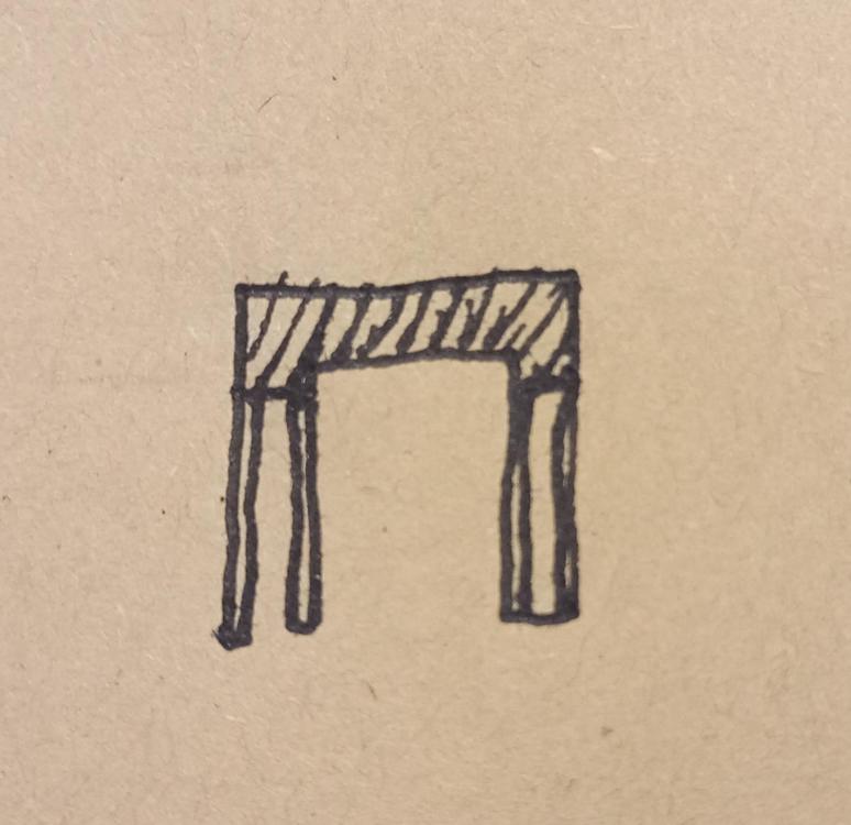

Seem to have lost a part for my P90 and can't find how to source a replacement.
Contacted Cyma but they refuse to help non-professionals !!
Not sure what the part is called but it joins the upper & lower receivers.
Rough drawing from memory attached.

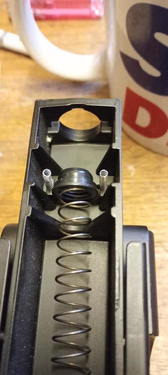

It fits over the 2 springs in photo.
Anyone offer any guidance as to how to identify and/or source a replacement??

Have a look at this VIDEO to see if you can spot where it is and let us know the time it is shown.
Or look at THIS parts diagram from a TM P90 which may have the same part.
Edited by EDcase
@EDcasethanks. It's at 6:40.
He's putting 2 parts together, and the bit the springs go into is the one ?
I've added additional photo to the post also.
Can't access the parts list unfortunately 'forbidden'.
Ah, I see.  Its the upper release button?
I think it could be 3d printed.
I'll try and make a 3d model of it.

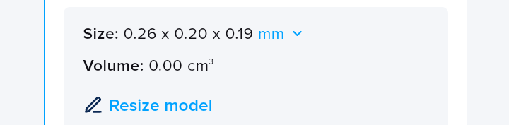

Should be: Size: 25.75 x 19.55 x 18.55 mm
Volume 3.94 cm3
If not then click on 'Resize model' and select 'Millimeters'
