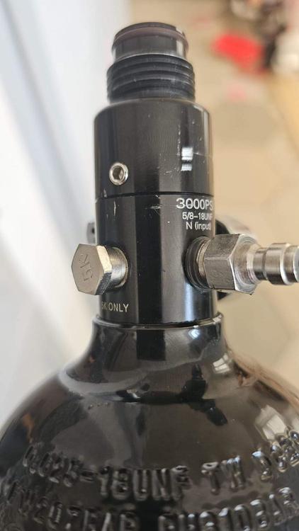

Bottle was leaking yesterday, let it empty itself as I could see an oring had shifted in the top of the bottle. Unscrewed it, reseated the oring and then screwed it back on, but only tight enough that I can still unscrew it (it won't go any tighter). As in the whole top part of the bottle came off (in picture).
Is this still safe to use? Should I just add some ptfe tape to help seal/tighten it?

What o’ring needed reseating, and where was the leak?
If from your description the whole regulator has been unscrewed from the cylinder and replaced it should not require any sealant, PTFE etc
Regulator threads are tapered and recessed in a manner that if you manage to unscrew whilst pressurised then the recess allows air to safely escape while the threads still grip. PTFE / sealant /  threadlock can interfere with the taper (and seal it) which keeps pressure as the regulator unthreads and can result in a flying regulator if it manages to unscrew enough without easing pressure
Provided there is no damage to threads in the regulator or cylinder and the taper is unblocked it would be safe
The regulator should be screwed on hand tight then tightened to a manufacturer specified torque, but without that torque is better hand tight then over tight

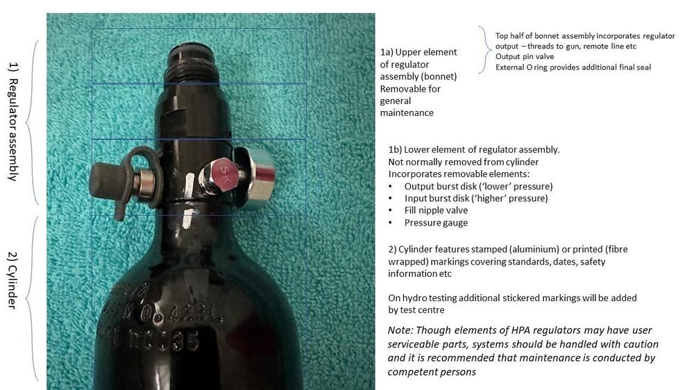

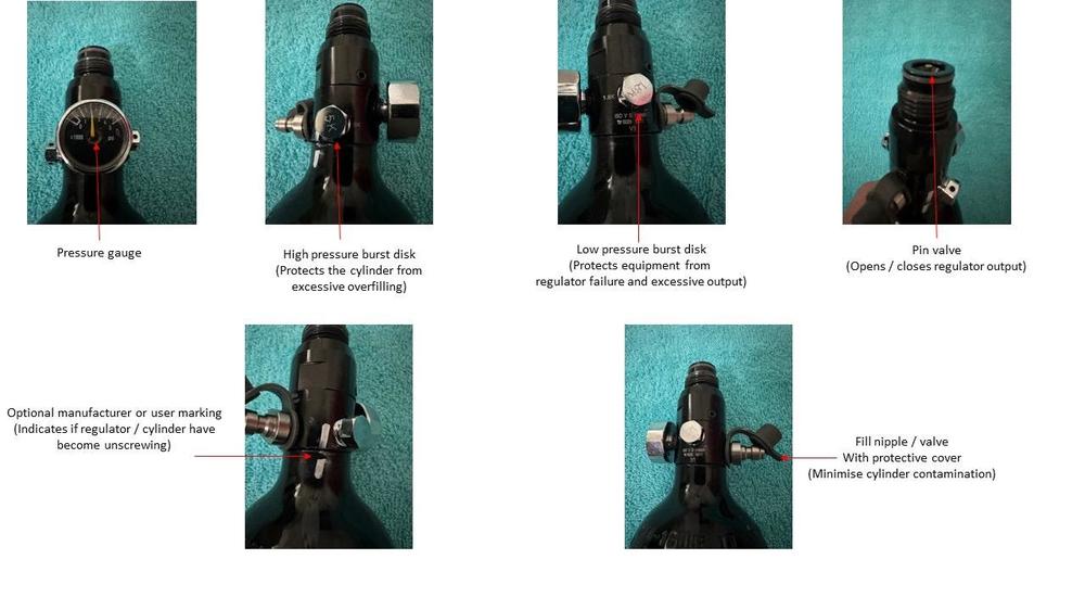

Regulator internal maintenance:
Regulator removal:
Alternative types & elements:
