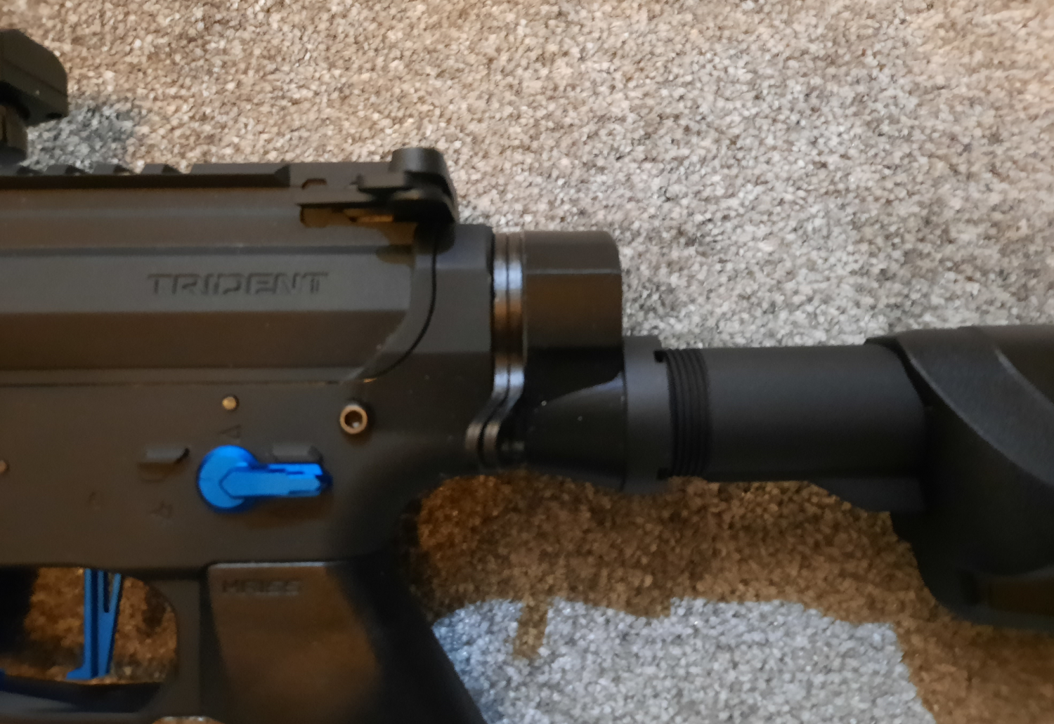

The adapter just fits between the Sling Plate and Buffer Tube.
As with most custom 3D Printed parts it will need sanding down before you try to fit it. Even with a hammer it would not fit the rifle without sanding (I do not recommend you try and hammer it on! You will break the adapter!). I found some coarse sandpaper and little model files worked best for this. You can grab a set really cheap on Amazon. I spent about 30 minutes sanding it while watching a movie and then it fit just fine.
With some Rifles the round part of the Receiver the adapter fits onto (The Buffer Tube Mounting Point) will be slightly too long for the adapter. I had this problem with the Krytac PDW and my choice of Adapter.
This creates a small gap between the adapter and the Receiver that the Sling Plate can rattle around in (Annoying!!!). It was only about 1-2mm wide but it was annoying me that it did not sit flush with the Receiver and Sling Plate.
Drop Stock Tutorials online recommend cutting off a small amount of the Buffer Tube Mounting Point on the Receiver with a Hacksaw to fix this problem. I really did not like the idea of that! I got around this though by doubling up on identical Sling plates to fill the small gap and it seemed to work just fine. As you can see in the above image I have two identical Sling Plates together.

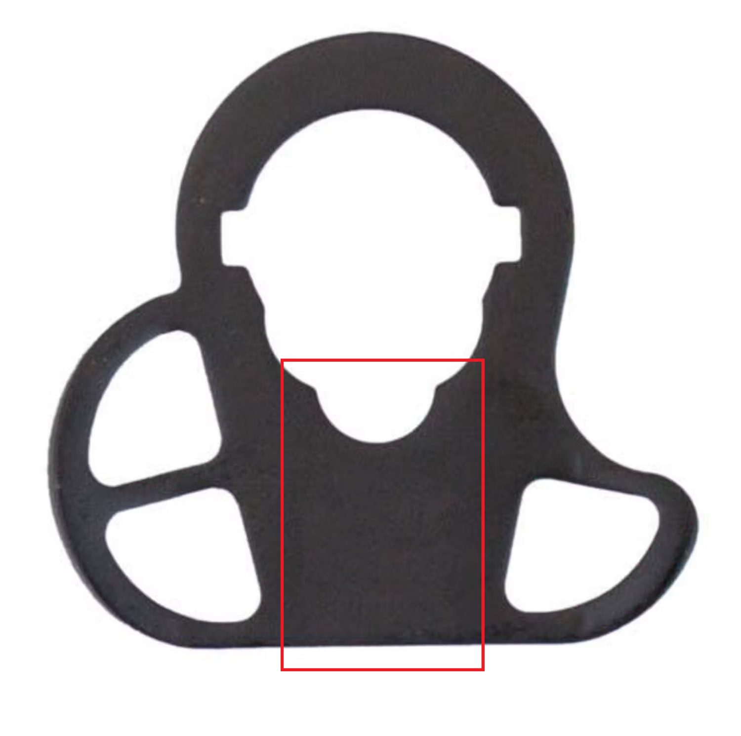

The only other thing you will have to do is modify the Sling Plates. Normally the wire will go directly out of the Sling Plate hole into the Buffer Tube. Now with the Drop Stock Adapter the wire has to bend down 90 degrees under the Adapter. I was unable to find a Sling Plate (in stock) online with a hole big enough for this.
This was an easy fix though. I just used a cheap Hacksaw to cut the bottom of the Sling Plates out. Shown by the red Box in the bellow image. No need to even do a good job (unless you want to :p) as none of it can be seen once the rifle is assembled. You will need to file down the sling plates after cutting. Mine were unexpectedly sharp and I now have a really bad cut on hand. They were so sharp I didn’t even know I had cut my hand until there was red all over the floor. So be careful.

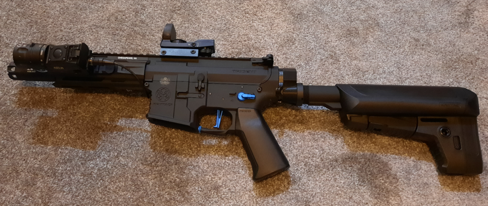

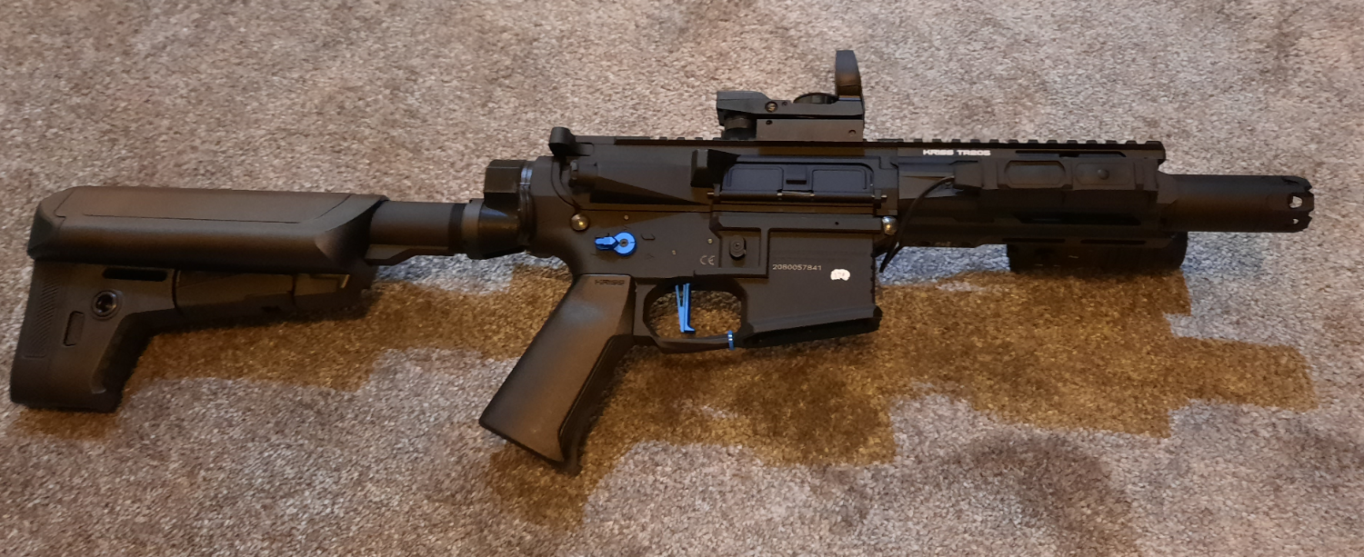

The end results.
I am really happy with this mod. Having a real adjustable stock makes for a much more comfortable firing position. The shape of the new Stock also sits better in my shoulder compared with the PDW Stock. The rifle also feels way better balanced. The new Stock seems to distribute the weight of the rifle better.
Overall it’s a very noticeable difference. The second from longest Stock position seems to work best for me with my choice of Stock.
The Drop Stock has done its job and I now have my Red Dot on the rifle at eye level with no stupid risers. I thought it might make the rifle feel a bit off, balance wise. You really don’t even notice it at all holding the rifle. Everything seems to be on nice and tight and I don’t think it would break.
Looks wise I’m also very happy. IMO the rifle looks way better with a standard M4 Stock and I love the look of the Drop Stock.
So I would 100% recommend this mod to anyone who has this rifle.
