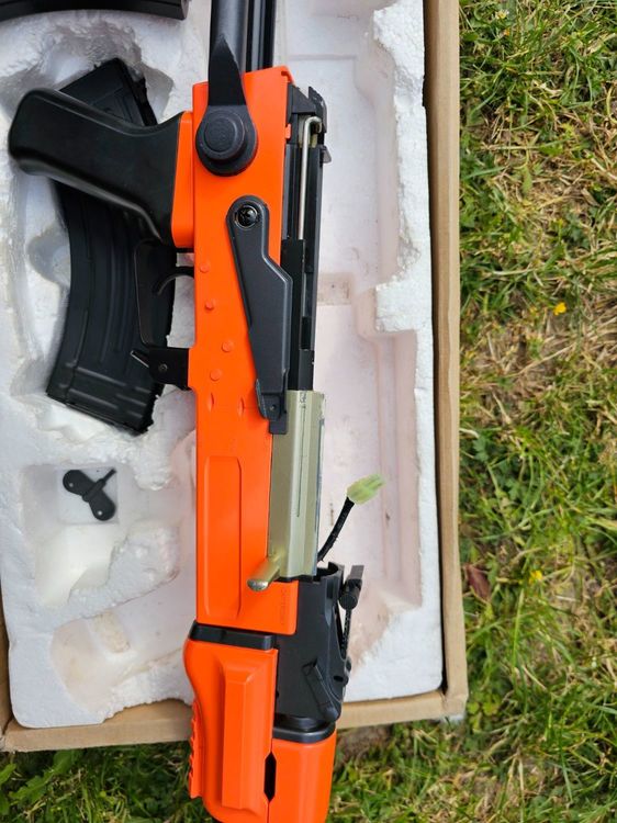

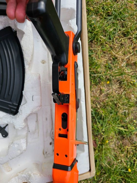

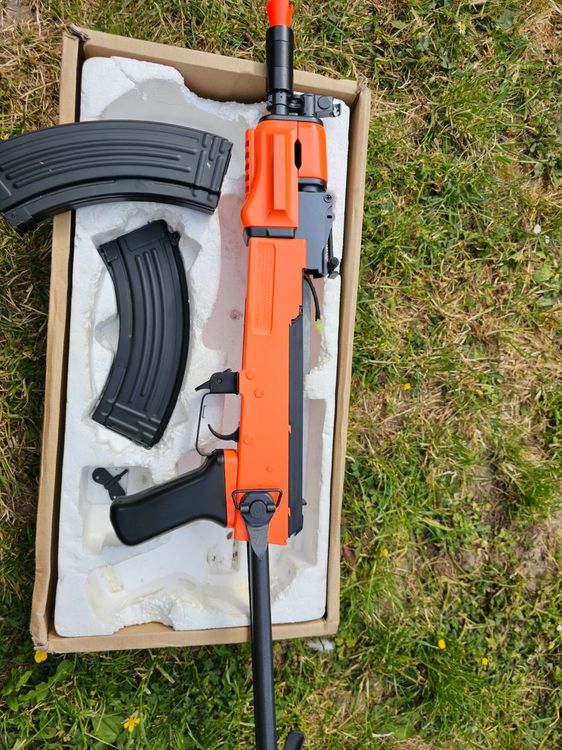

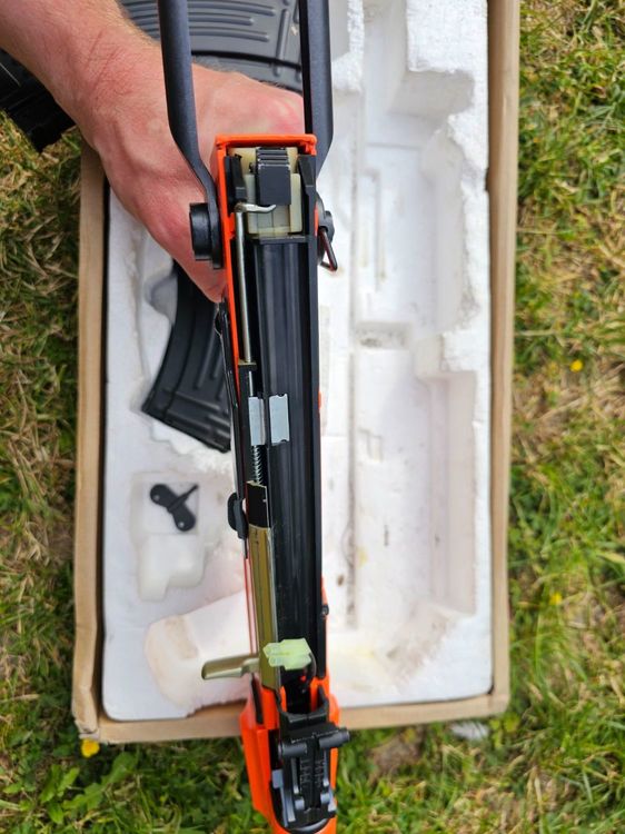

Morning All,
Recently gifted the AK but airsoft knowledge is non existant
Would love to bring it back to life
Perhaps someone has similar or knows what model this is/could be
From the looks of it battery and top/battery cover is required
Can someone shed some light onto this please?
Regards
Welcome 🖐
My guess its a Double Eagle M901C
This is a quick list of things so you may want to do some more searching based on these to get better price etc.
Battery: Airsoft 7.4V 1400mAh 20C LiPo battery LP051 Vapextech (Chose Tamiya type connector)
Charger: SkyRC e3 LiPo Balance Charger 1.2A 2-3s SK-100081 (modelsport.co.uk)  (Look for a more advanced one if you want to get more into airsoft)
Probably worth getting the battery and charger first to make sure it works before spending more on the top cover.
Top Cover: ARCTURUS AK Receiver Cover Rail | Patrol Base UK | Airsoft  (Not sure if this fits so best to ask them) (Could also put an advert in the forum 'Parts Wanted' section)
