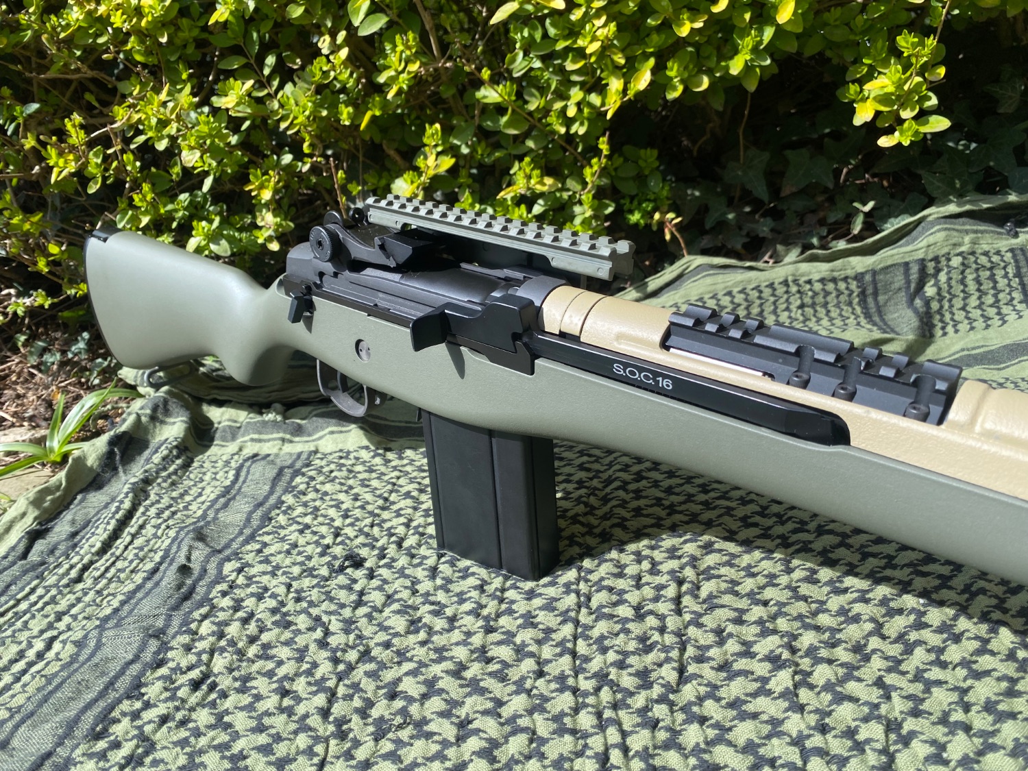

G&G M14 Socom 16 Barrel upgrade
KieronHill
I cant remember whether its G&G or G&P that use some proprietary parts in their M14s, though I think thats more around the mag & hop unit.
What youll probably need is like the below, a barrel that has 2 notches in it rather than the standard 1. As the M14 hop unit is a different length to most others. Or if youre handy with a dremel, any barrel will do if you dremel your own notches into it :P
I use a Modify Hybrid 6.03mm barrel in my Cyma M14 and Im very happy with its performance.
Precision inner barrel Lambda One for AEG and M14
