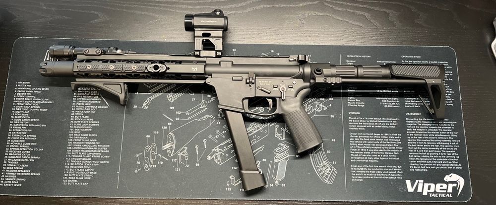

So with a few UK retailers now stocking it. I thought this might be a good opportunity to show off our TWS 9mm GBBRs.
I got mine about 4 months ago from HK, shortly before I found out that UK retailers were getting stock.
I’ve not really spent much time with GBBR ARs so this has been a steep learning curve. Because the TWS isn’t quite an AR-15, nothing really seems to have fit as expected.
Changes so far:
- bifrost tracer instead of the steel flash hider.
- CNC light weight bolt
- Rainer Arms charging handle
- ace1arms tactical G17 magazines
- G&P PDW stock
- guarder light weight buffer
- 3D printer buffer tube short stroke discs
- G&P BAD ambi selector
- Magpul MOE grip
- GBL Cpt America hop unit
- Nineball purple hop rubber
- maple leaf 6.02 SS TBB
- Modified I-Key
- RATECH anti reversal pins
- RATECH magic receiver pin
- steel counter sunk screws for the M-lol rail (imo the ones supplied out of the box are not suitable).
I’ve also modded the bolt stop to accept TM magazines. So now the bolt holds open on empty for all my G17 and G19 magazines.
I’d like to fit a flat trigger or a burst kit, but both are proving hard to find for the WA system. There’s a retailer in france with stock of both, but he wasn’t respond to my emails and his online payment system is down.
