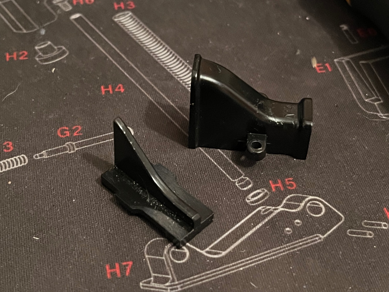

Yes BUT you need to know what drum mag the AK adapter is for, they have different bb feeds, unless you put your own Bowden tube in the feed ramps won’t line up EXCEPT I think I have M4 ramps in the drawer ?
Thanks for the tip, looking at the adaptor its says M4 drum mag needed. Could I in theory swap that MP5 ramps out for M4 ones?
Edited by EvilMonkee
Yes
held in by two cross head screws
These are the bits you need
Easy enough to replace with a short Bowden cable if you wanted to
