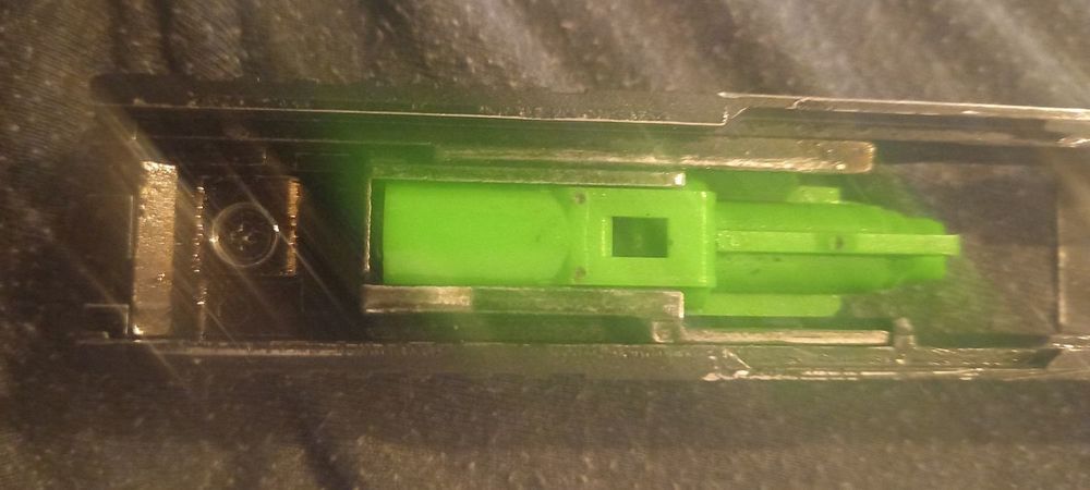

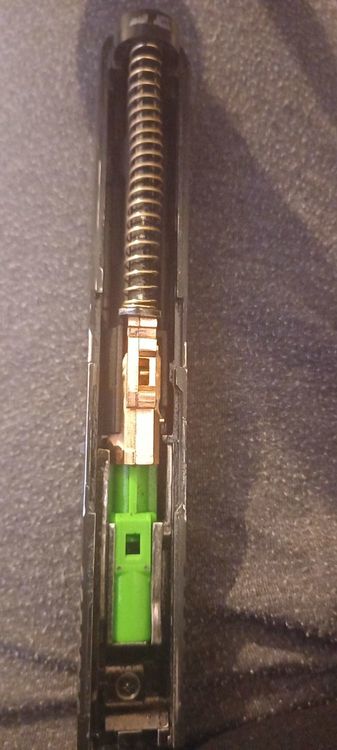

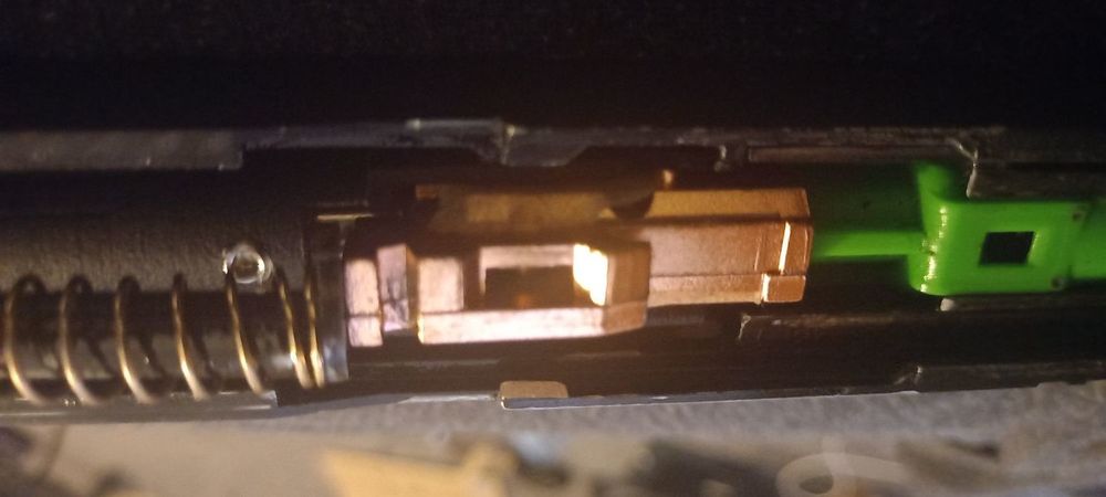

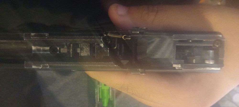

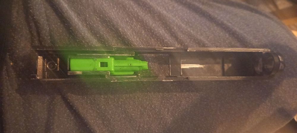

So to sum it up the top slide seems to be rubbing on something trigger related, I'm not to sure on where the sound is coming from this also seems to corolate with the sticky side I have atm it has a roller bearing and I'm going to replace it with an sfk on soon but I'm not sure why I'm having this issue, I've put pictures to where there is heavy wear on the slide I'm sort of assuming that has something to do with it, thanks for all of you who reply too

sorry about the pics my phone is a piece of shite if you need more specific shots let me know
Put the standard outer barrel back in, I can’t tell anything from the pics, sorry
