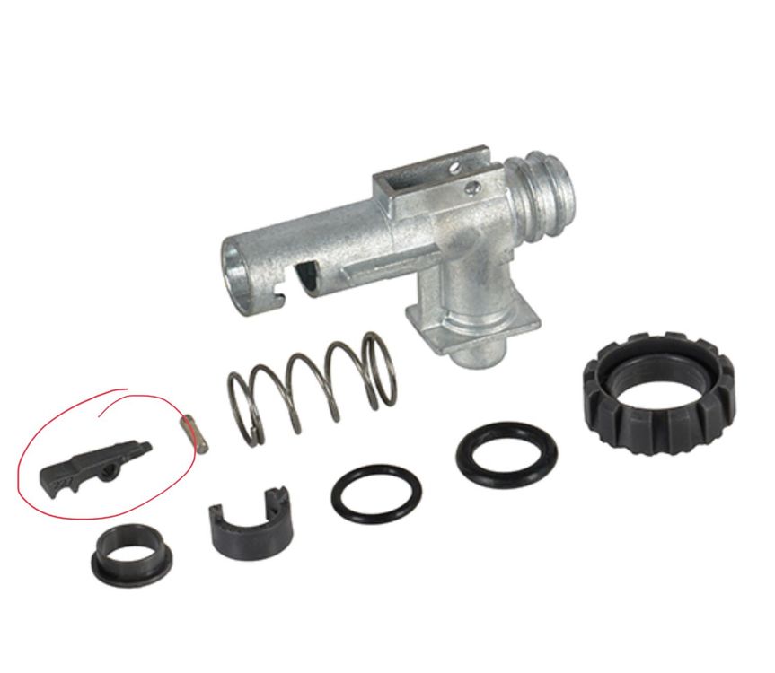

@colinjallen Thank you for your answer. From the time is wrote the post above and reading your answer, I stripped the gun again. Looking down the barrel and the hop fully open or closed, bb's just fall through. After adding a piece of foam to the hop (just as an experiment), I finally could see a lip forming on the bucking. Reassembled the gun (at this point I could not get the fire selector in place and it's full auto all the time), and did a test fire. My hobby room is 4 sqm, and I didn't even hit the wall....
Tomorrow, I'll run strip it again and follow your instructions. When you say feed tube, you do mean the opening of the hop unit, correct? In regards to the hop unit, I have attached a picture of it.
Yes, that is the rotary hop unit.  The feed tube is the one at the bottom through which the BB's feed up from the magazine.
You don't need to take the gearbox out to remove the hop unit and barrel or to do the tests that I mentioned.  Does the hop unit have an arm similar to the one circled in the photo (this is not the CA Scar chamber) or is it missing? There should be a rubber nub at the end of that arm that presses down on the hop rubber.  There should also be a narrow spring on the lug on the top right of your hop chamber; this helps to push the chamber firmly against the gearbox.
It has the arm but nothing else.
Spring wise.. there is a spring on the front and its a tiny little thing.
I ordered the bucking and nub. Should be here tomorrow. I assume without the nub I cannot really test for air leak?

You can test for air leaks with just a hop rubber in place as you are checking the seal between the nozzle and the rubber.
