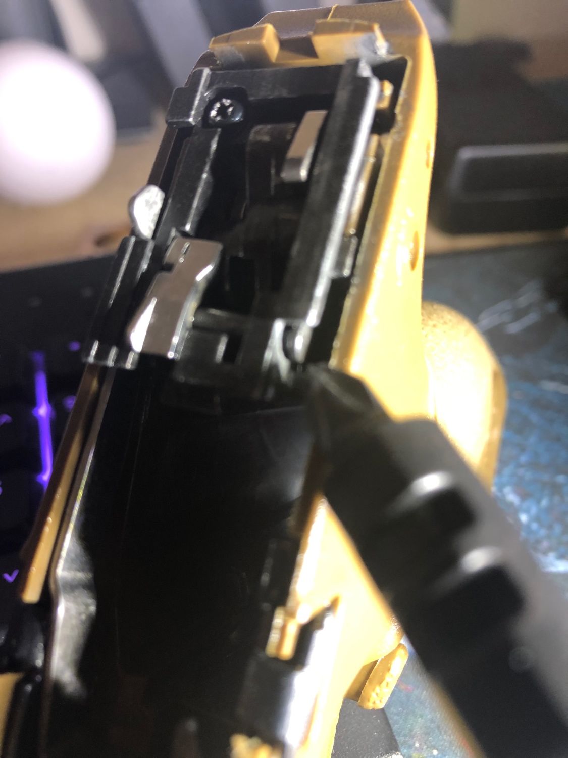

To anyone reading this with similar issues, I found the problem with mine was on the full auto sear coming loose. It didn’t look like anything was wrong until I started specifically inspecting that part. The full auto sear retaining pin was moving out of place when the slide was pulled back causing the slide to stick. On both the side of the pin and and on the edge of the sear as it slightly angled up as the pin moved out.
 I solved the issue by pushing the pin back in and then slightly mushroomed the end to hold it in place. No more bursts of auto and no more sticky slide problems.
This is the pin in question, identified at the screwdriver tip. The silver plate to the left is the auto sear, just make sure they are all seated correctly and either glue or mushroom in place. A8A407BB-22FC-4E95-BBC8-EC1319B80EBB.thumb.jpeg.2dee81b27358850a2ea1b540724038e0.jpeg
Hope this saves someone else a few hours of stress trying to figure out what is wrong!
