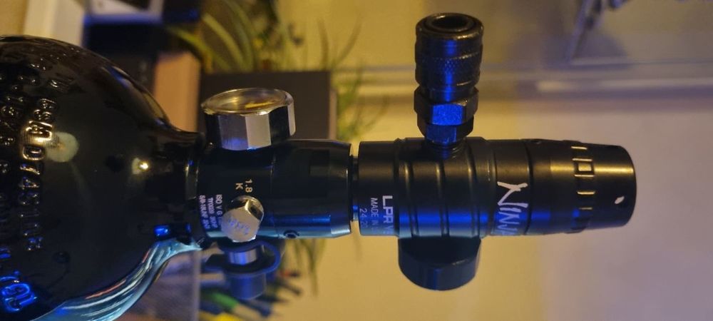

Sorry if this has been asked before, but i thought i'd ask before i potentially turn my bottle into a bootleg missile.
Can i remove my SLPR regulator off of the bottle with compressed air still in it?
Many thanks
Yes sir! You can either just unscrew it, but you will get a poof of air released when the reg comes off. Or, you can turn the reg right down, purge it by connecting and disconnecting your line a few times, then just unscrew.
Just be careful that you’re unscrewing the lpr from the bottle reg, and not the bottle reg from the bottle!
Awesome, thank you very much! It indeed worked. Cheers!
