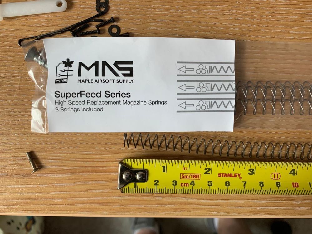

Maple ones come as a one-piece and are a universal fit for up to 250 round mid-caps. So you are required to cut them to size and there is no guide for PTW Pmags until now ?

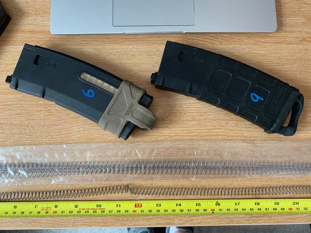

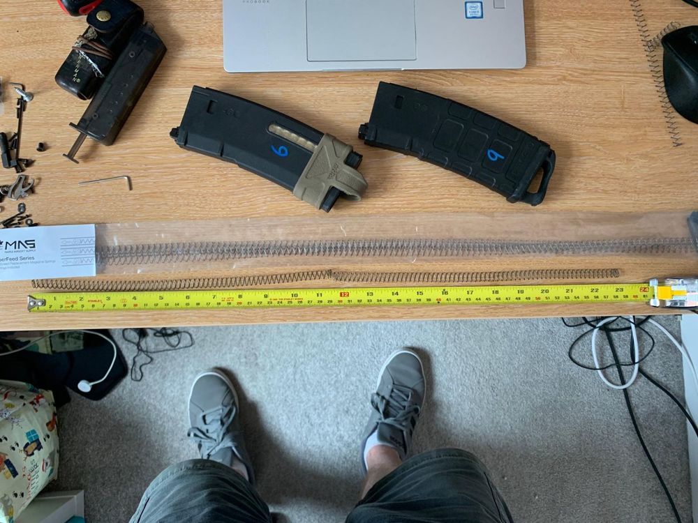

The PTS Mags with MAG springs seem to take around 110-112 out of an original 120 round design.
Apparently, If you manage to fit the entire thing into a 120 round mid-cap, you can only fit about 45 rounds in. Pretty sure the force it would throw BB’s out would cause double feeds but I’m not going to test that.
Here are the results of the cut Maples
Super spring relaxed 55cm – 99 rounds
Super spring relaxed 51cm – 111 rounds
