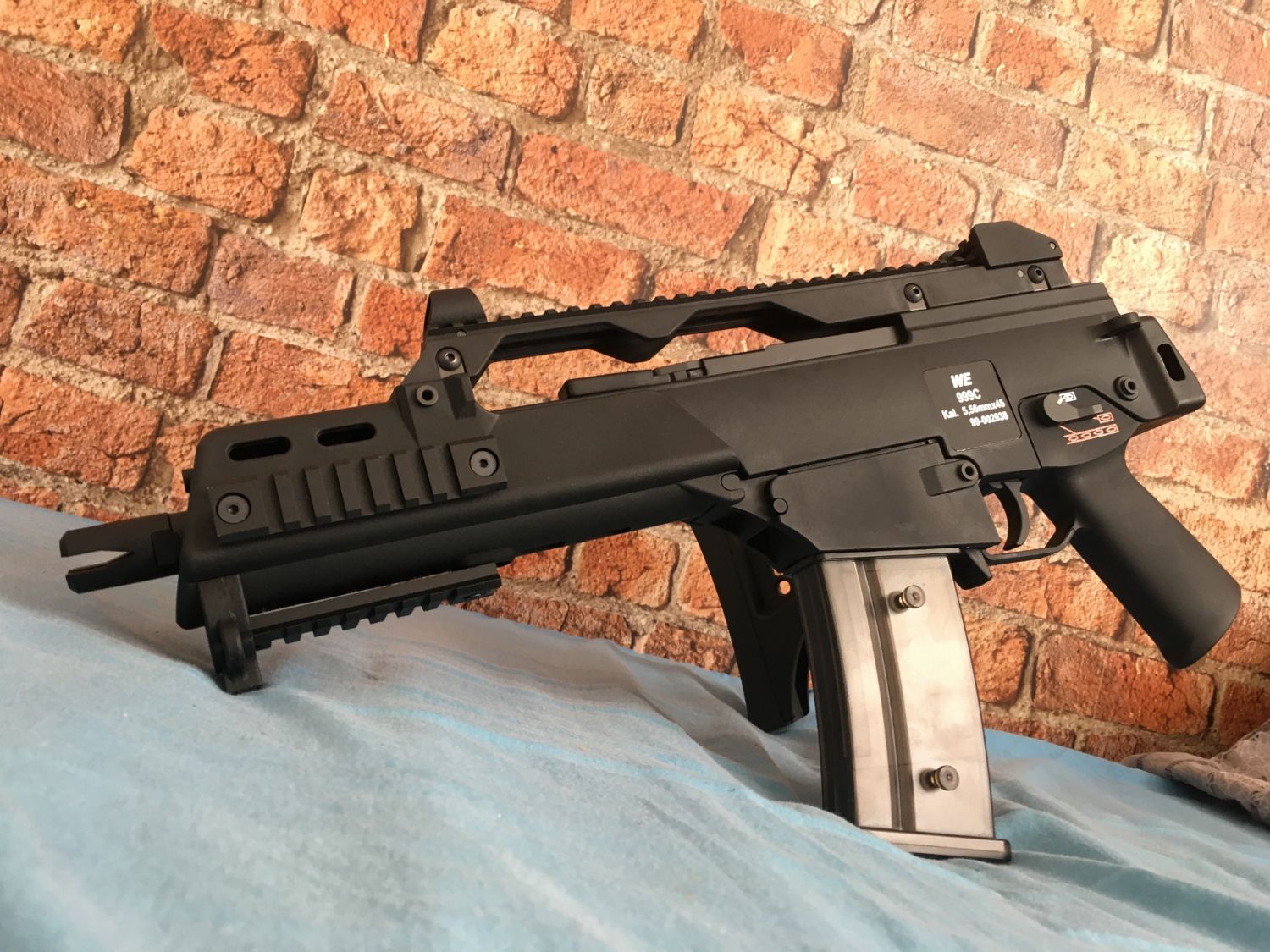

I would love to hear any and all opinions on what I could do or whether I should just stick to RA-Tech npas compatible guns such as my WE 999c (G36c) which is my first and only rifle thus far (seen below).
