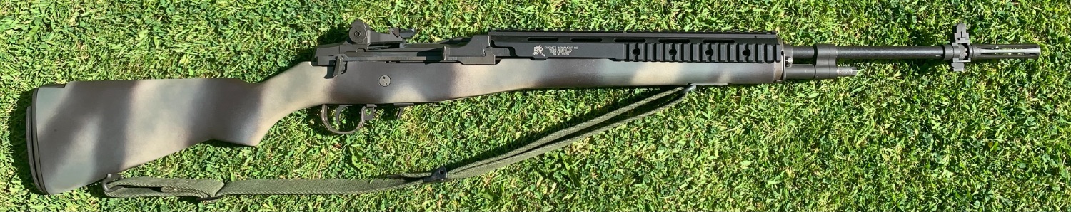

Hi all, currently setting up a WE M14 and was wondering if anyone has any tips and advice on them.
So far I’ve only bought the RA Tech trigger mech housing. On my list is a RA Tech 6.01 barrel, ML 70d monster hop rubber, RA tech NPAS KIT.
It’s currently semi only at the moment but looking at changing this with adding the NPAS as I think I’ll get more enjoyment using it without having to worry about the MED
One thing I found hard to find was a low profile mount. I’ve ended up getting the WE low mount as all the others were out of stock.

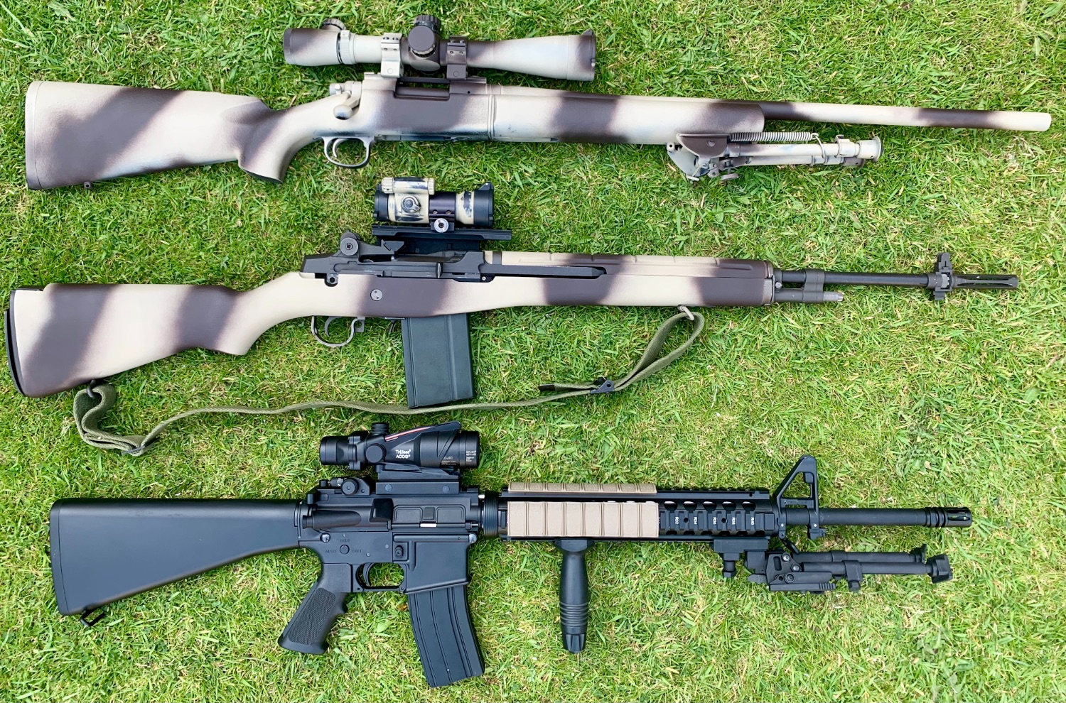

Hey buddy thanks for the reply. When I can find the Ali nozzle I’ll be getting one. I ended up buying the NPAS kit, ratech barrel, ML monster rubber 70d and it’s already hugely improved it. Not sure what FPS it’s running at yet, need to get myself a chrono. The scope in the pic is a genuine aimpoint so that should hold up. I have ordered a Leupold replica MK4 M1 scope though. See how it holds out haha
Some more bits to get yet
