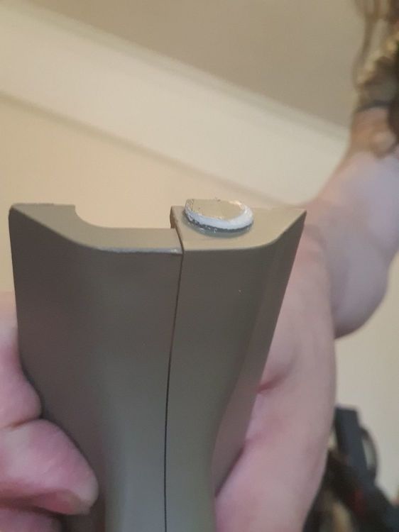

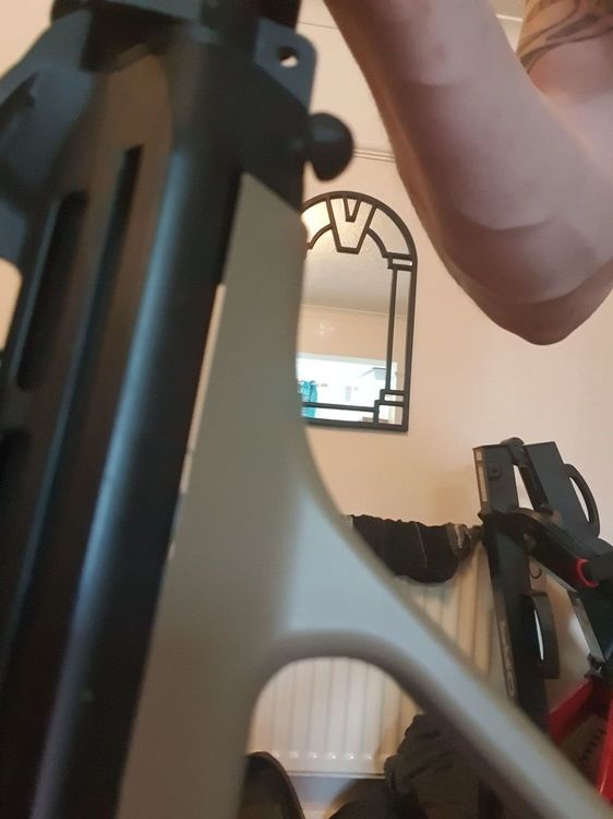

2/ the upper and lower have accrued a gap (picture attached) i think its a case of the body has a nub on it that slots into the metal front end, and its worn just enough to make it not sit flush and hold it compact, any advise on getting that repaired would be great

Hey, I need to know more about what you have done to the gun since you got it.
Upgrades - What have you taken to bits, Did you try to rebuild the hop, Anything like that.
This is because I think you have a spacing issue with the gearbox or hop that is stopping the upper seating correctly, And I can't help if I don't know what's been done to it.
If you have rebuilt the hop, Shimmed the inner barrel ect then I need pictures of that.
I also need pictures of the inside of the magwell and the front of the gearbox.
The amount of damage to the lower is pretty bad, I've had AUG's for years and never seen anything like it. The only way I can see that happening is user error. It looks to have enough meat left on it that it should still work if the cause can be found for the body not sitting right.

I think the issue was me, i didn't realise the nub wasn't sitting properly
When you slide the upper onto the lower there's a checklist of sorts.
The pin needs to be in the open position.
The cocking handle wants to be forwards.
Inspect the hop and make sure the extra little plastic bit on the back is in place. That little black plastic bit is a vital spacer, without it the gun won't work and you'll need a complete hop unit to get a replacement.
Slide the upper onto the lower, And make sure it goes on smooth. You should be able to feel the hop touch the air nozzle, and the last 3-5mm of the seating should be a little springy as the hop/barrel spring take up slack. Make sure the front pin fully engages and then push the body pin into the locked position. When locked the gun should have no gaps, and the body pin should be holding itself in place.
I need to see the magwell as it may be damaged. If the gun is forced together it's often the front of the magwell upper that breaks, Same if you shim the gearbox forwards. Depending on the break it may outright kill the gun if you damage the feed tube as well. Sometimes you can get lucky and have it break but the feed tube still sits correctly or doesn't get lost/damaged.
