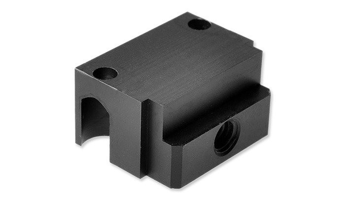

As per title, does the Army R85A2 rail fit the ICS L85A2? I'm guessing that I'd have to use the same adaptor as required for the G&G version of the DD rail? Anyone know?
army-l85-ris-metal-cnc-foregrip-2.jpg eng_pl_MadBull-Daniel-Defense-L85-RIS-Rail-Adapter-for-ICS-L85-9490_3.jpg
The lack of replies suggests that no-one here knows....
In that case, does anyone have an Army R85A2 and can show me how the rail fits on to the rifle, so I can compare it to the DD model?

2 years old, but just found this and figured as I have experience with both (Buying the army A1 to test the rail on the ICS), it does not fit without some major filing and adjustment that overall isn’t worth it compared to getting the Madbull DD and adapter. The AA rail is thinner than what is needed for the ICS rail.
