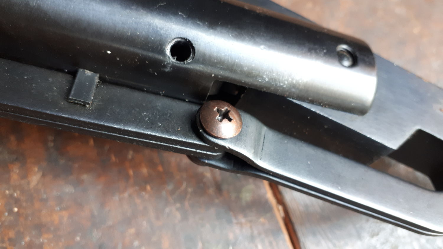

I found an old SMK 19 in my shed (no idea how long it's been there) and having some time on my hands right now decided to check it out. It does work and can still be fired but the pin (see pic) keeps falling out.
Any ideas how I can repair/replace this would be most welcome.

replace it with an internally threaded sleeve hex bolt and washer either end. or steel bar with grove cut either side for a clip

Thanks. Any ideas where I would get such a thing the correct size? Or am I asking a dumb question and even B&Q do them ?

Screw fix or amazon will be better. you just need to measure the diameter of the links

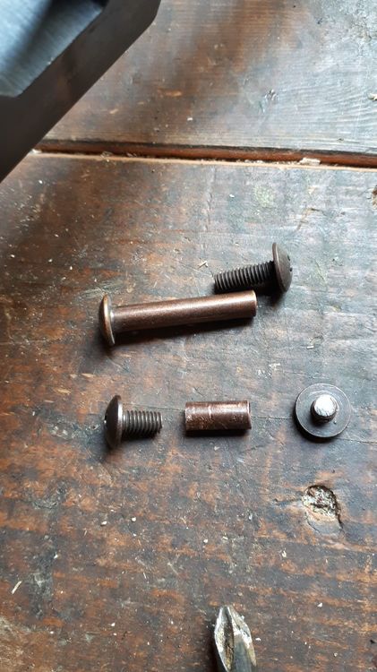

Man went to shed and man found things in a tin...........one of those things was an internal threaded thing with a screw one end. Precisely the same diameter. I cut the threaded thing to the correct length and then cut down two screws and fitted one either side. Hey presto done. A bit of light thread lock and voila....happy days!
