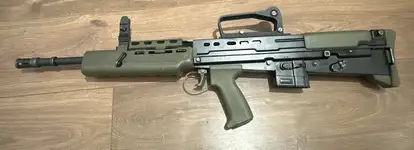

GRIZZLYBEAR Members Joined Jan 7, 2023 Messages 28 Reaction score 64 Yesterday at 8:06 PM #2 No. It's completely different. I hade to modify mine to fit a real hand guard.

GRIZZLYBEAR Members Joined Jan 7, 2023 Messages 28 Reaction score 64 Yesterday at 8:21 PM #4 spitfireuk said: what did you have to modify to get it to fit? Click to expand... Click to shrink... Iv attached photos. You have to ad a block to the bottom of the existing "gas block" to allow for the sling loop bolt to hold the hand guard in place. First image is original WE, second is my modified gas block
