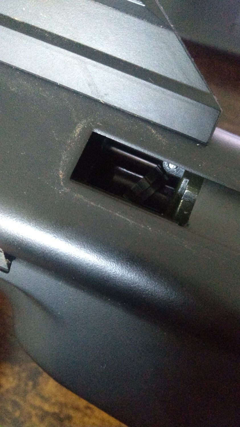

I've recently bought a WE L85 and have used it for one game with no issues.
However when I removed the upper receiver from the lower some kind of metal part came loose and I have no idea how it goes back into place.
It's a small spring like part next to the trigger but I have no idea how to put it back into place

It's the spring for the safety . Bit of a fiddle to fit properly , but here is a picture of mine in position .
Nick
