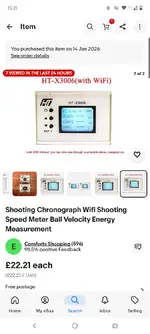

I'm having a few issues and could do with some advice. I don't have access to a chronograph unfortunately at the moment, getting one after Christmas.
