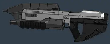

I'm still working on the MA5B. The gun is largely done, but I decided to design a 3D printable gearbox for it rather than making it just HPA, which is currently in progress. Looking forward to putting it all together.
Still WIP, things not done yet.
Has very much a "gun I drew when I was 5" look to it.
