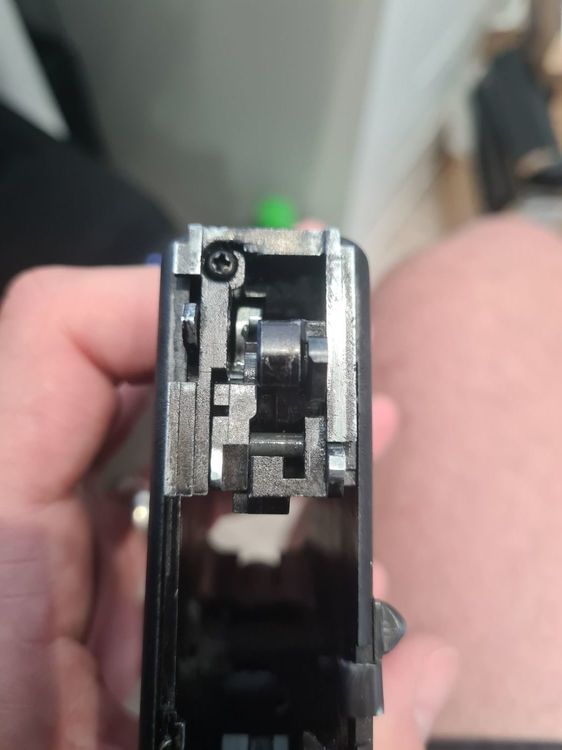

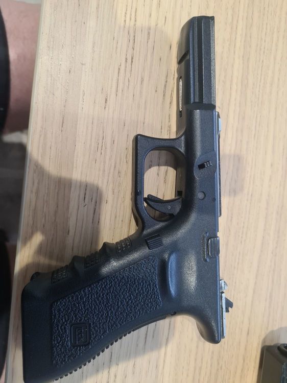

Here you go a few pics of the gun and the mags. I've also included the exploding parts diagram from the manual.
Cheers
Ok so this morning I swapped over the entire hammer unit assembly from my WE Glock 26 into the TM Glock 18c and the gun fires perfectly.  The WE G 26 no longer fires the TM assembly is not compatible.
So the issue must be something to do with the hammer assembly in the TM.  Given I have changed the spring out already to a gaurder advanced I am a little puzzled.  Any thoughts?
I might just buy another WE hammer unit and put that back into my WE glock 26 and be done with it!

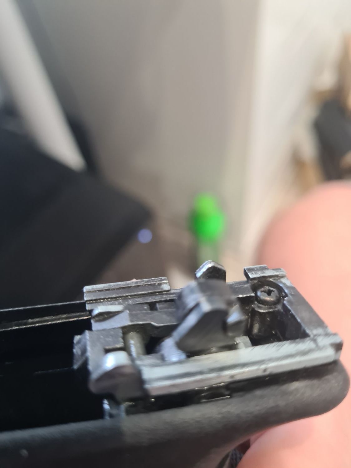

More pics of the problematic TM hammer assembly.  I'm wondering if the sear is worn?

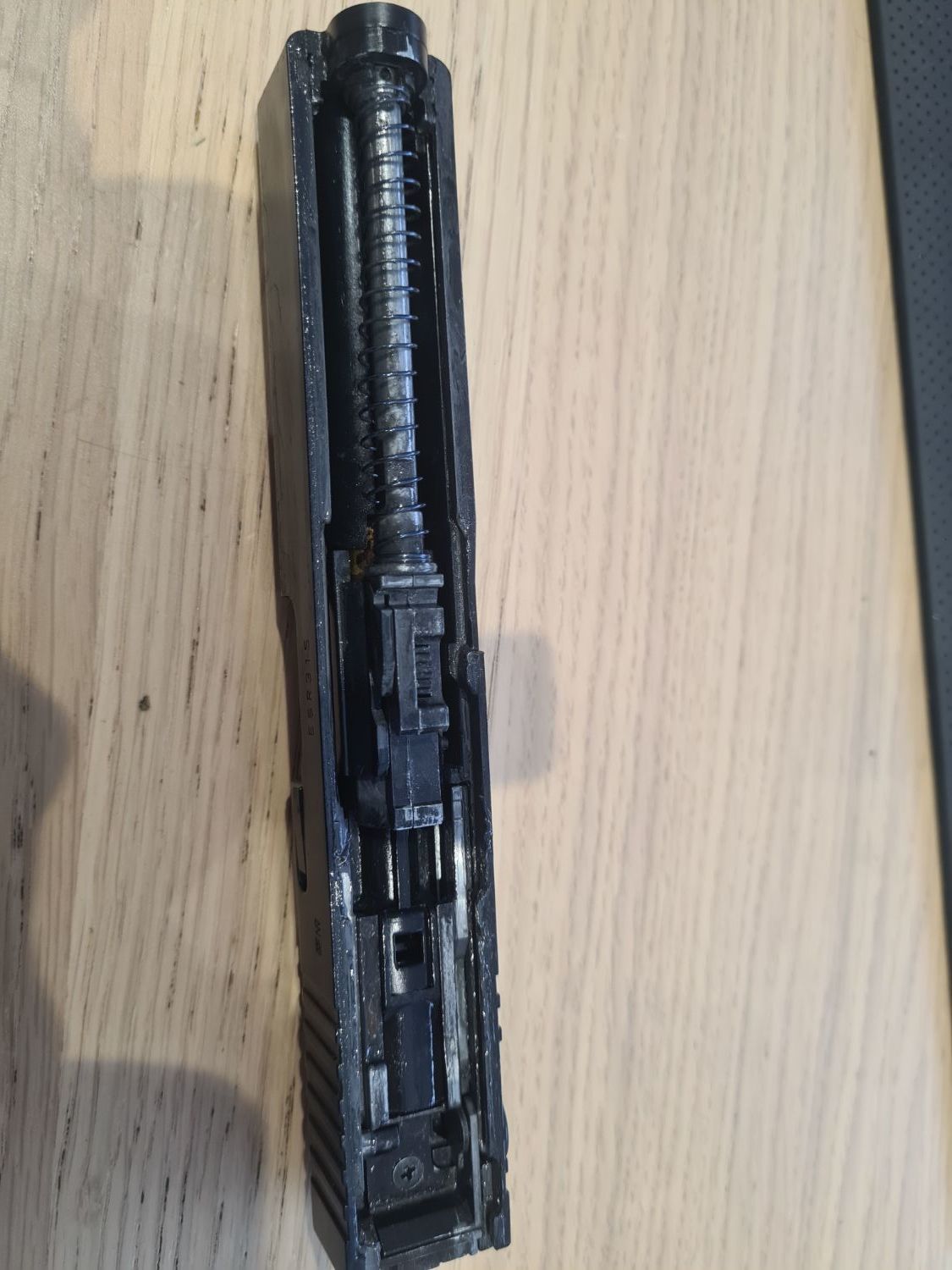

The slide looks like it’s metallic, is it just the dirt?
Obviously everything else looks standard TM, but slide looks dirty
I still don’t get the problem you’re having, I’ve never had an issue where the more I fire it, the better it gets.
Have you tried the TM on the low powered gas it’s designed for ?  It’s possible there is too much pressure in the mags for a TM
I am also super puzzled with this issue.  However it definitely goes away after I fire half a mag, then comes back if I leave the gun for a few hours.  I'm wondering if I have put too much lube on the gun or the hammer unit and once the gun fires a few cycles it helps free it up?
To answer your earlier question the slide is plastic however there are metal components inside it.  It has silicone lube on but I cleaned it before I applied the lube, so is probably the light reflecting off the lube that makes it look metallic.
Anyways I have fixed the issue by replacing the TM hammer unit with the WE hammer unit, seems like others did the same  if you check the description and reviews here https://www.milspecsolutions.co.uk/we-g18c-hammer-assembly.html
I'm going to buy a new one of these and put the old one back in my WE glock.
