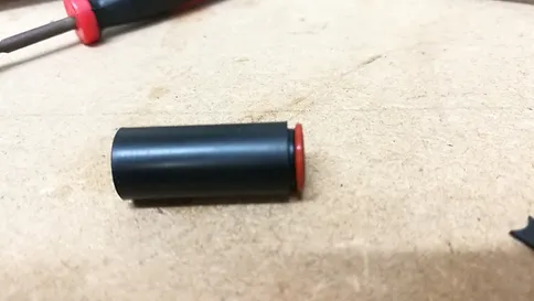

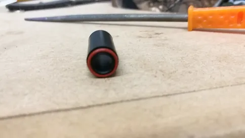

Airbrake - The airbrake is something I've been doing on my rifles for years and was a key design in the WASP series of pistons I've been working on. What this does is greatly reduce the sound of the rifle, but slowing the piston down at the end of it's travel and essentially restricting how fast the air flows though the cylinder head.
This causes a drop in power on light ammo, but has a neglibable effect on heavy weight ammo, the idea being that slower/gradual air release allows for a longer (albeit we're talking hundreths of a second) release of air. When paired with a heavy piston this combination works great, though isn't always suitable for super high joule builds, the benefit of the airbrake (in my WASP atleast) is that you shotr shorten the airbrake and change the diameter, so you can tune it for your personal preference.
My current working theory on this is that there is a slight delay before the BB grips the hop up, especially when the air is delivered fast and abruptly, however when an airbrake is introduced, you slow this down, easiest way to explain it is a car pulling of the starting line, to much apower and it skids, energy is wasted and there is little grip, leading to a false start, by slowing this down you increase the torque and in THEORY you grip better. This is a working theory and something I've been looking into a while.
Easiest way to install the airbake on a standard piston is to drill a small hole (possibly thread) and insert a plastic rod which is cut to fit.
8bc9a1_3b4e470a29d1493287aee69694eee2c4~
