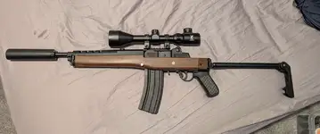

So - for many years I've had an increasingly battered box in the corner of the spare room, stuffed with packaging - in order to serve to catch BBs when chronoing, testing feeding etc. Every now and then i was sticking new sheets of cardboard to the front as the previous sheet disintegrated. Whilst serviceable, really it wasn't a tidy application.
So I finally got round to making a simple plywood box, with 5x 'kentucky' hop heads fixed within it (hung off a three layer pass of tight paracord latticed at the top of the box. I mist say, it works really well - silently catches the lightest lowest power BBs up to the heaviest BBs i use in the sniper. Super cheap as well. Measures about 40cm high by 25 cm wide.
