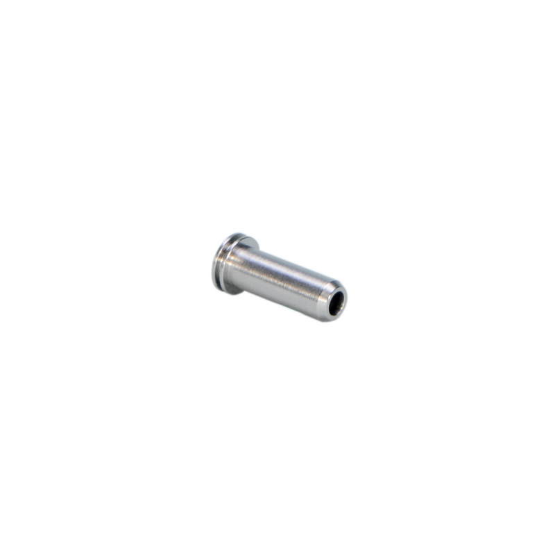

In the process of identifying issues, I came across a problem with the original nozzle being worn to buggery, and endeavoured to find a replacement, as its a somewhat non-standard size at 22.25-3mm. I purchased a maxx brand one in 22.3mm and all seemed fine until it got to checking fitment between nozzle and hop unit. The Maxx nozzle has a very hard step about 2/3rds down that effectively stops the nozzle going far enough in. Now it will fit with forcing, but obviously that's no good for a part that needs to move somewhat freely.
My question is, would it be better to try modifying the nozzle to fit, or modifying the hop unit?
Or, even better, does someone know of a nozzle that would fit without issue?
